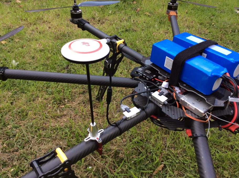

update on my gps sitch....
i positioned the puck smack bang in the middle inbetween my batteries and also paid special attention to exact cog mounting positions, my copter is now flying great....not 1 gps loss after 14 flights.
you still have the problem Smithy?
Ye still as bad as ever, is there any chance you could send a pic of your positioning please, i have mine just off centre on the left side where the majority of GPS pucks are. Thanks a mill buddy...
This is where I've put it.....I may get blasted for this but it works and that's where it's staying :)

SmithyFpv
Interesting ok, and since you've had no issues? Have a shoot tomorrow so i'll see how the new update for the A2 works and if no improvement i'll try this! Thanks a mill for the picture Glennyboy...
