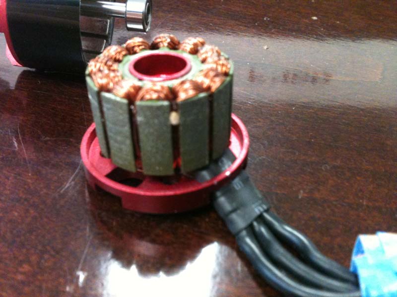

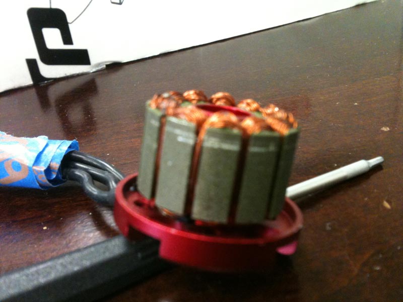

I took the opportunity to pull these two motors apart. I was surprised how little there was to getting in there. All that is required is to remove the e-clip on the bottom end of the motor. After the e-clip comes out, a small washer should slide off. The motor then simply pulls apart, exposing the stator (the winds), the 2 ball bearings, and the magnets attached to the inside of the housing.
Once apart, I found a small pebble wedged between two of the windings on the stator. The magnets looked clean, but had a small film of dirt on them, which I found as I wiped them down.

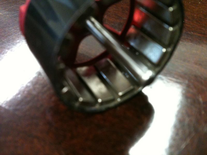

On the 2nd motor, the stator looked clean, however I found some tiny metal shavings stuck to and between the magnets.
I cleaned up and reassembled both motors. They both spin better than new!
