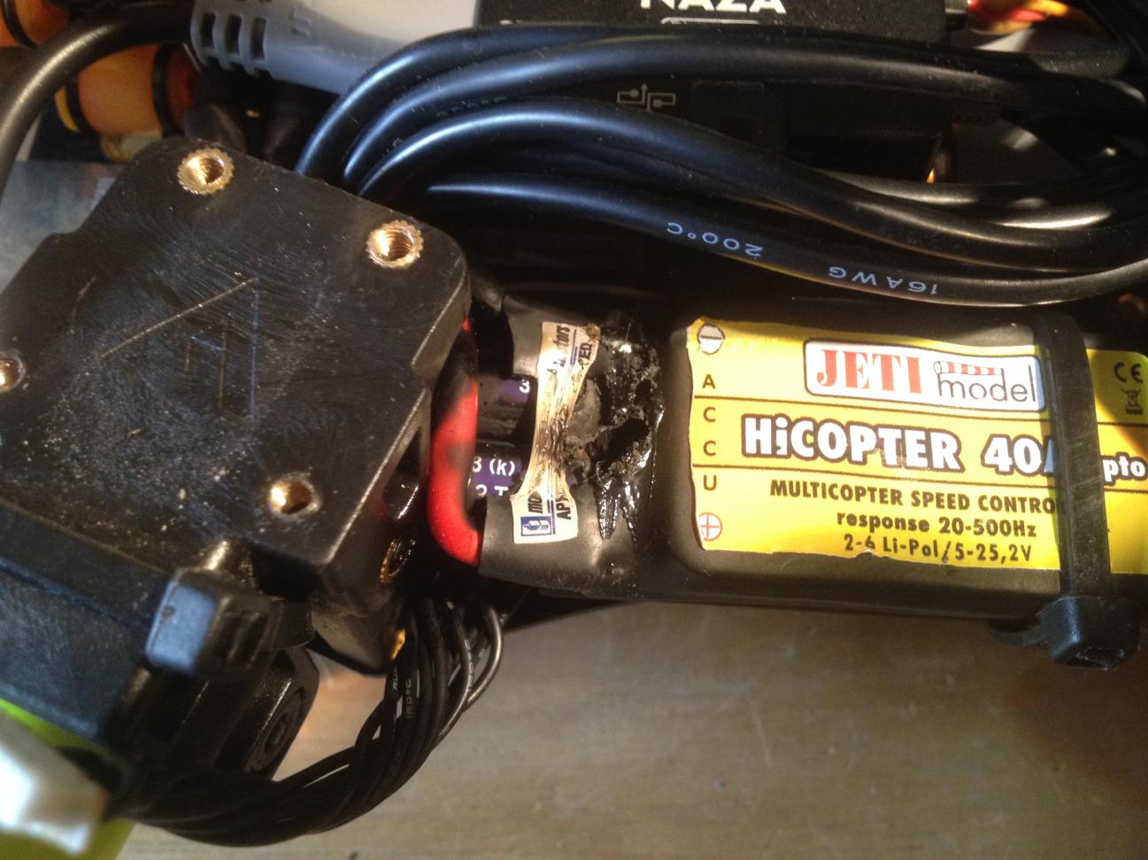

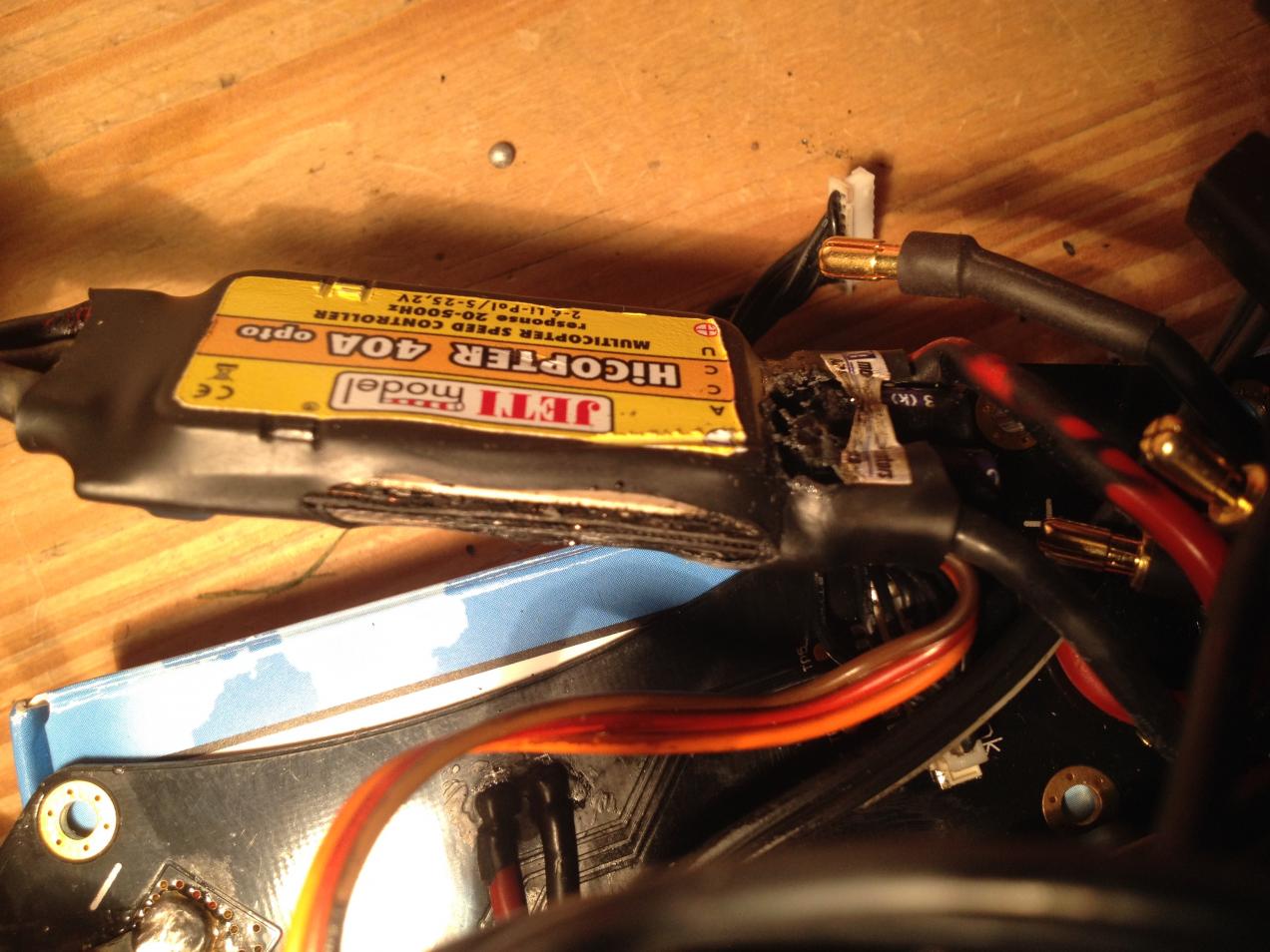

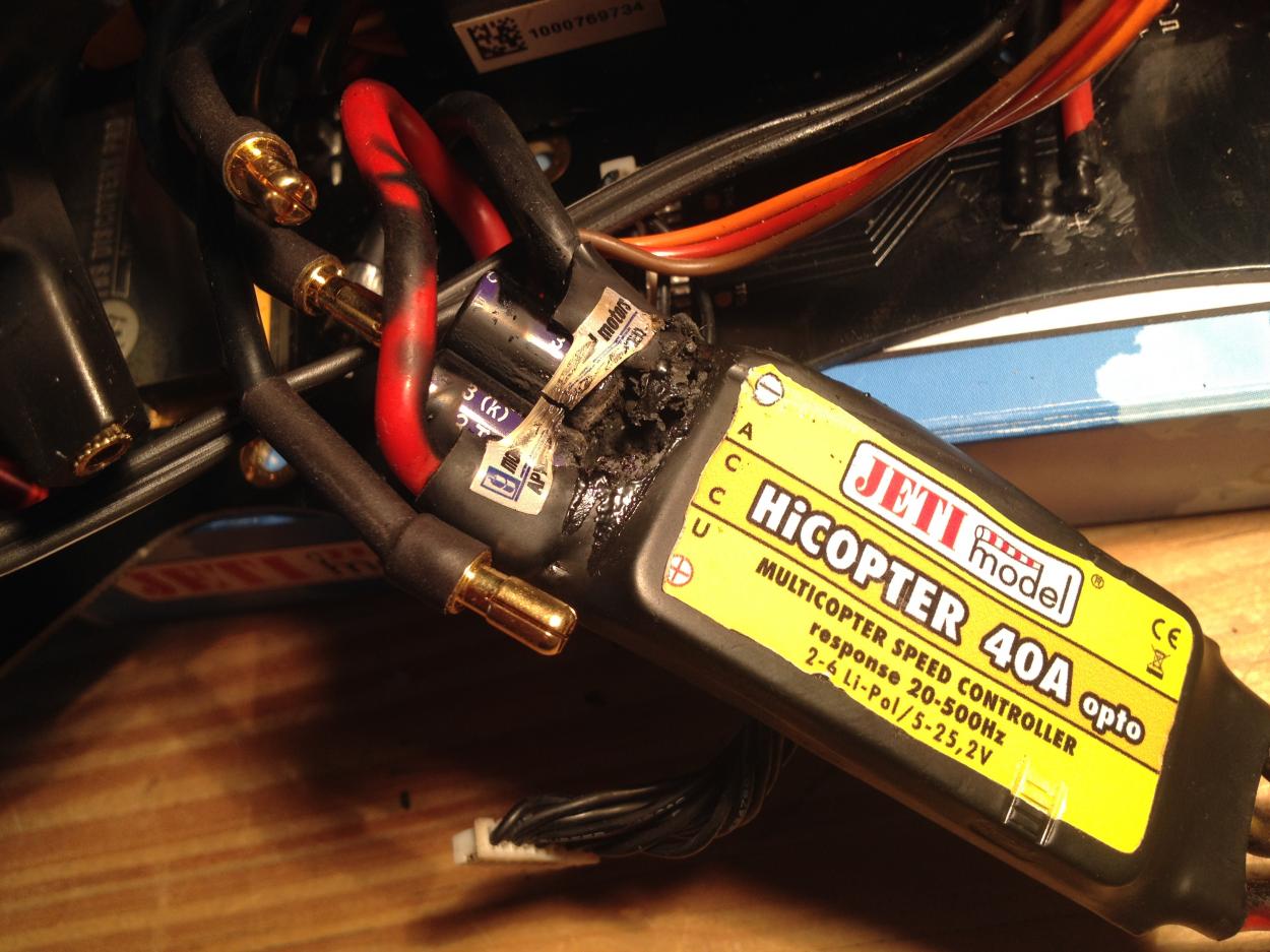

Been trying to sort out why when yawing the disco I've been getting a huge wobble - it's alright on small rudder inputs but put the stick all the way across and it only just remains in flight before recovering itself into a nice flat pirouette.
About 3 minutes into a flight this afternoon one engine stops for a beat then restarts just before the quad hits the deck. 20 seconds later smoke starts billowing out of one side of the quad and then the engine cuts again before I can get it down.
So I'm thinking I've found the cause of why I was having trouble yawing!
Now was I asking too much from the 40A esc or was it just a faulty esc? I had noticed on a previous flight they were quite warm but not to the extent of combusting on me midflight!

Sorry but I don't think it was the Jeti ESC that let you down - I think you abused it and it gave up as a result, i.e. any other brand of ESC would have succumbed too. From the images, I see that you had the ESC stuffed (quite brutally) into the fuselage space rather than mounted on the arms. The capacitors (and probably the FETs too) would subsequently have been deprived of cooling airflow and, probably most significantly, the power wires look like they've been forced against their will to conform to the chosen layout. Soldered multistrand wire is prone to breaking strands internally when you do that. The breaks diminish capacity, produce internal arcing and the result quickly becomes what you have there - a fire. :(

Hi Jes1111,
The capacitors not getting airflow could possibly be a factor, although (from my admittedly limited knowledge of capacitors) they should not get warm enough to need a constant airflow over them to keep them cool, also this position has been used by other disco pro users the no issue what so ever. With the power wires would the internal arcing cause a breakdown/fire on the wires themselves or could it cause it internally infront of the capacitors? The Aerial Mob arms allow quite a lot of space under the boom for the wires so dont think the wires were too "abused" but I want to eliminate every possible idea before trying again - thanks for the info

I'm no electronics engineer, but I do know that what's happening inside those ESCs is the electrical equivalent of "hell on earth" - the current is being "chopped" into a PWM square wave to feed the 3 phases of the motor. This chopping produces massive back-EMF spikes/ripples on the power input side. The capacitors' job is to absorb those spikes/ripples - which is what causes them to get hot and (eventually) break down. Broken strands inside the wire, poor soldering, mechanical cracks/stresses - basically anything that's not right in that area can cause what is already barely-controlled "electrical bedlam" to turn into "electrical armageddon".
In your first image, the positive wire is bent back over the capacitors at a very acute angle - solder will inevitably wick up inside the insulation with this multistrand we use and causes a brittle junction where the solder stops and the bare copper starts. This is (one reason) why the manufacturers apply heat shrinks that bind the +/- wires to the capacitor barrels - it supports and therefore protects that vulnerable point of the soldered wire end. Add vibration into the mix and you can see why anything less than "perfect" treatment and arrangement is a weak spot that will give up at some time.

henry
did you have anything under the ESC like a layer of foam or silicone sheet? it's possible that the ESC got hot but a full blown meltdown like that was probably either a short or a component failure like a FET or something. putting the ESC's up against the tube mount like that wasn't a great idea and if the ESC was sitting on a hard surface then the vibrations probably got the better of it.
henrysj
hey Bartman,
