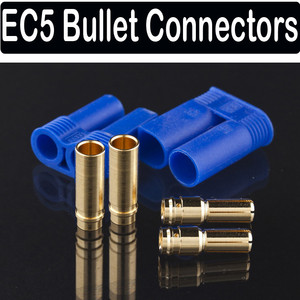

I've decided enough is enough, I can't stand pulling these deans connectors apart. What connector do you guys recommend?
I did some research and was surprised Deans is only rated up to 50 amps continuous load: http://www.rchelicopterfun.com/rc-lipo-batteries.html
Dean plugs are a relict from the past.....I replaced everything from 2S up to 4S with XT60 plugs, 5S and 6S got EC5 ...and now I am happy. With the EC5 you must just watch out...you get them with banana plugs or with bullet plugs. Bullets will last you longer...
