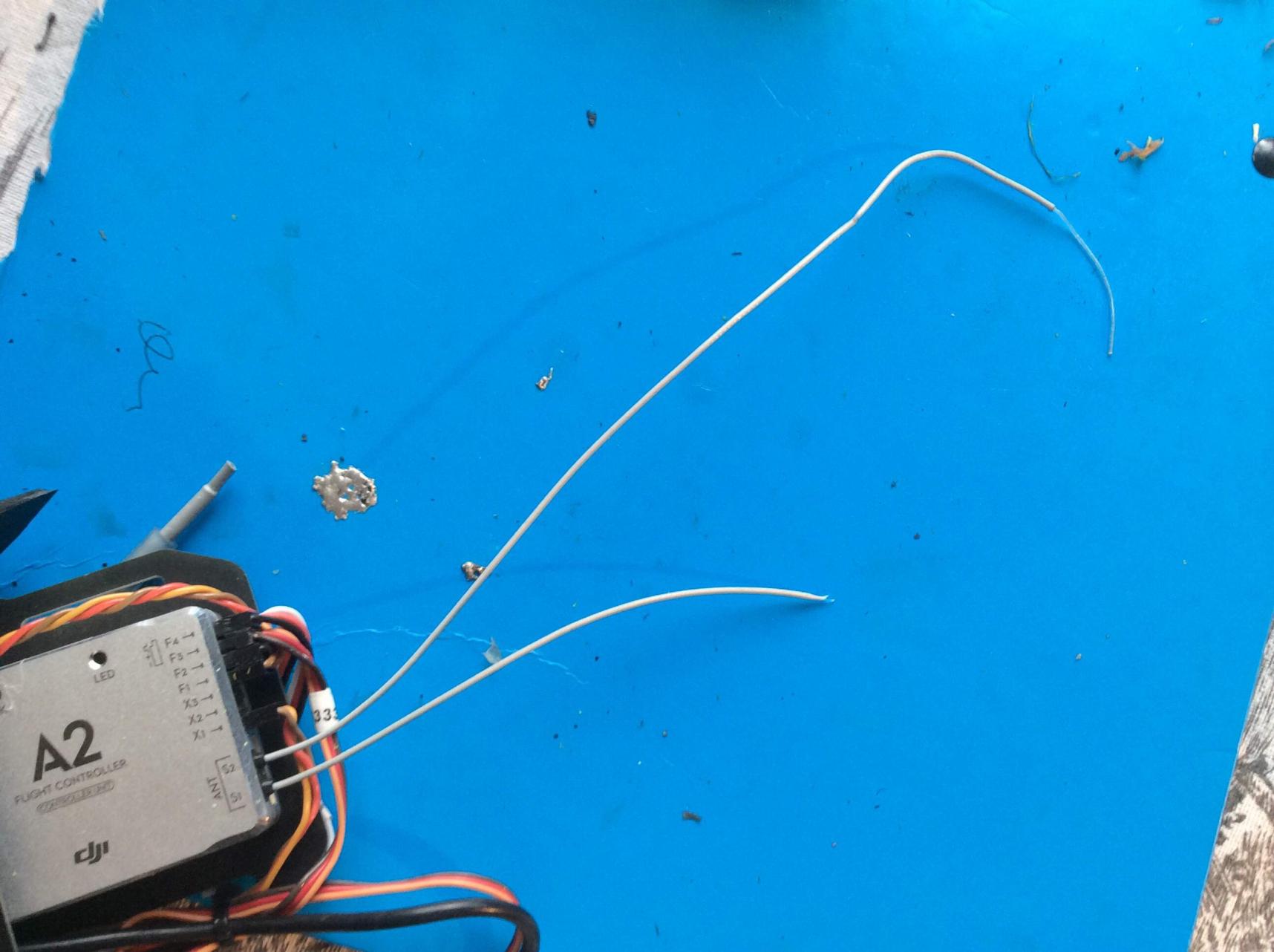

Can anyone tell me if the antenna on an A2 FC is cut, as per the photo, if this will effect things?

mk, with those wire antennae the part that receives the signal is only the last inch or two, where the wire is bare. the rest of the wire is there just to get the antenna part away from the receiver for proper positioning.
like the others have said, the one wire being damaged will affect performance of the receiver.
mkheng
Ah not good news then. I've since found out the other antenna is damaged, just before the bend, I've bared back the inner wires on both and re soldered the ends on. Will that work? Not done a test flight yet as it's been pouring today.
