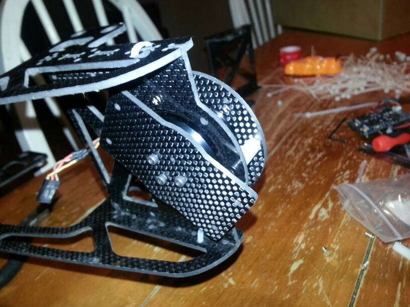

Here's how I mount my gimbal now. Custom made carbon fiber mount.
Sent from my GT-I9305T using Tapatalk

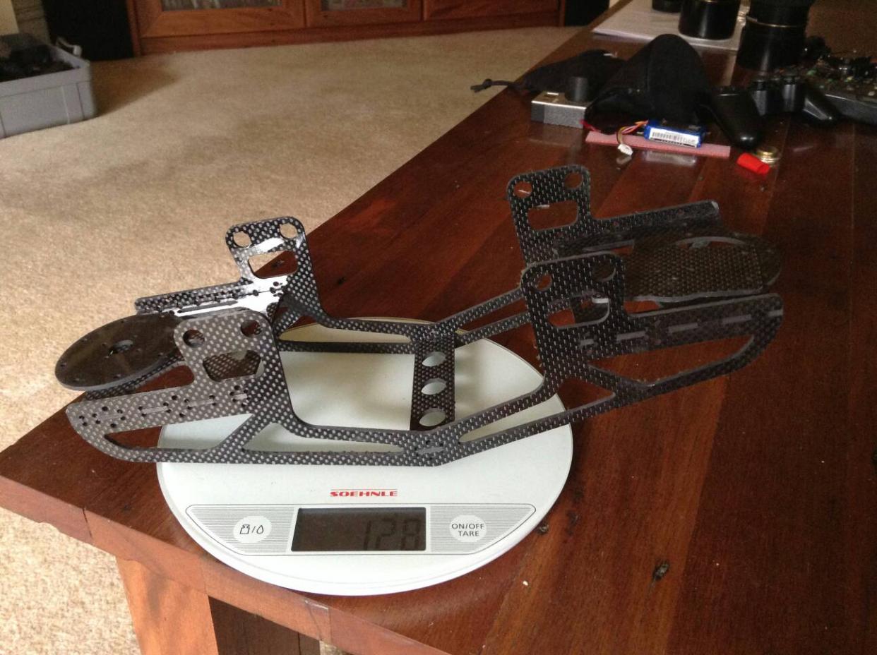

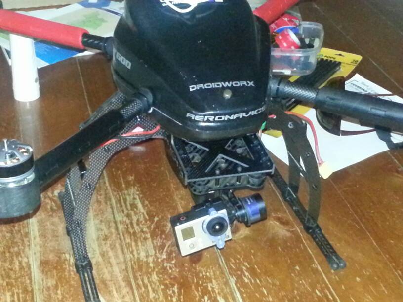

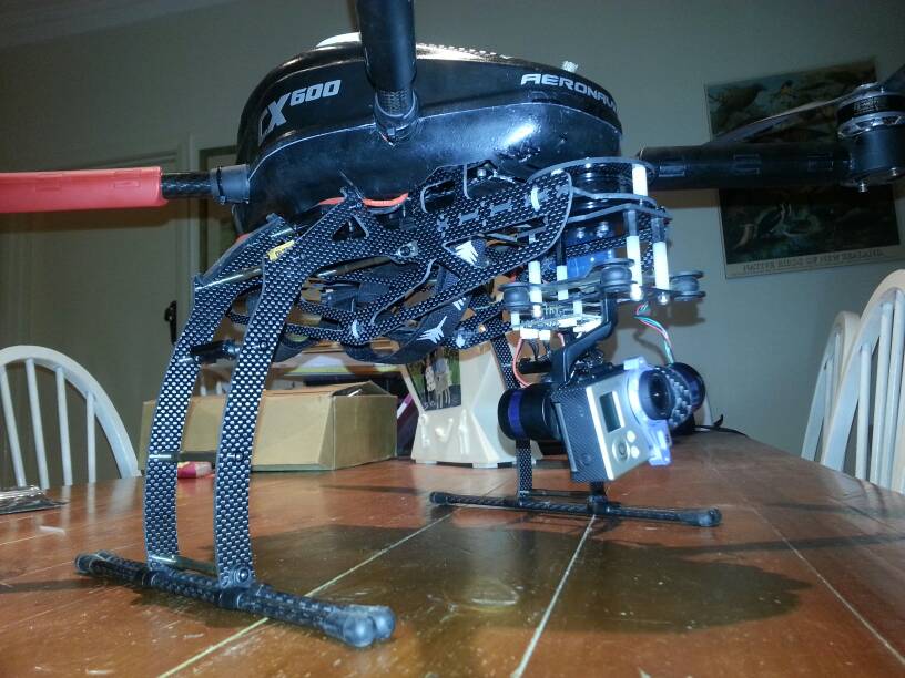

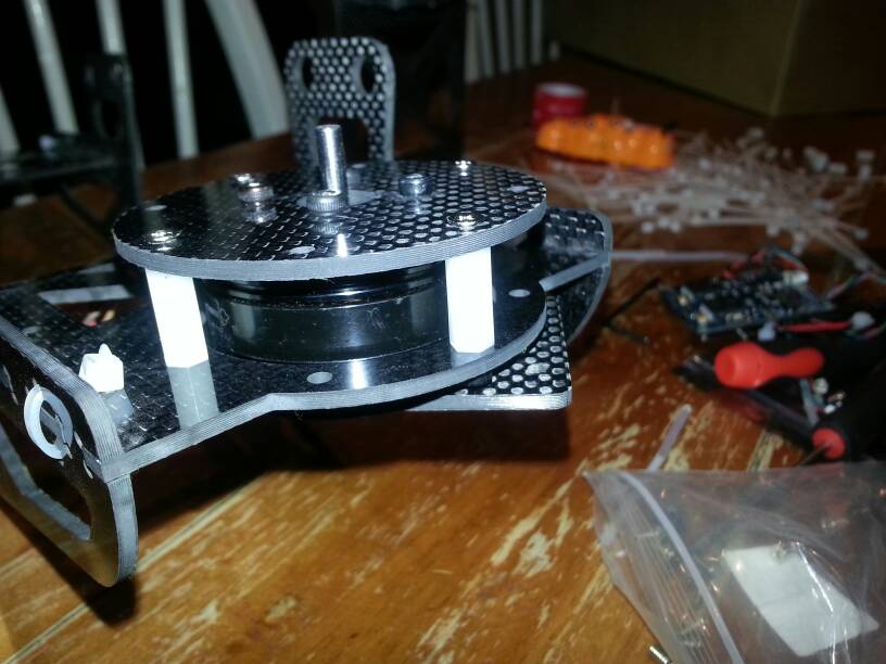

nicwilke
Here's my new gimbal and battery mount. It holds a 3 axis gimbal for yaw smoothness.

nicwilke
So excited to test this in the air tomorrow. No slop on the mount, its as rigid as hard mounted, the only wobble is from the actual anto vibration, as per normal.
