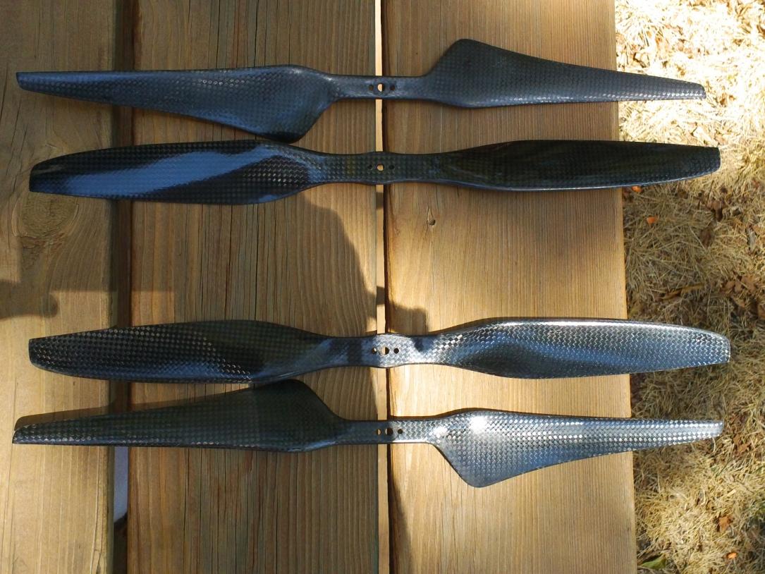

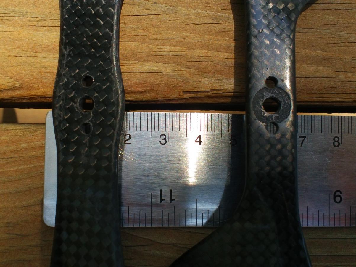

for my S800, I ended up purchasing about 10 pairs of these:
View attachment 5262View attachment 5263
from http://www.foxtechfpv.com/1555-carbon-fiber-propeller-cwccw-p-542.html
But I just saw this guy.. that looks to have the same as OEM and looks even less for 2 pairs.
http://www.ebay.com/itm/2-Pairs-Carbon-Fiber-1565-15x6-5-CW-CCW-Counter-Rotating-Propellers-/180901215463?pt=Radio_Control_Parts_Accessories&hash=item2a1e8d7ce7#ht_1611wt_936
I may ended up getting 4 pairs of those 1565 from that A1 Hobby group to try. I also see that he has some other knockoff of the DJI F550 ARF kits.. I could use several of those too.
