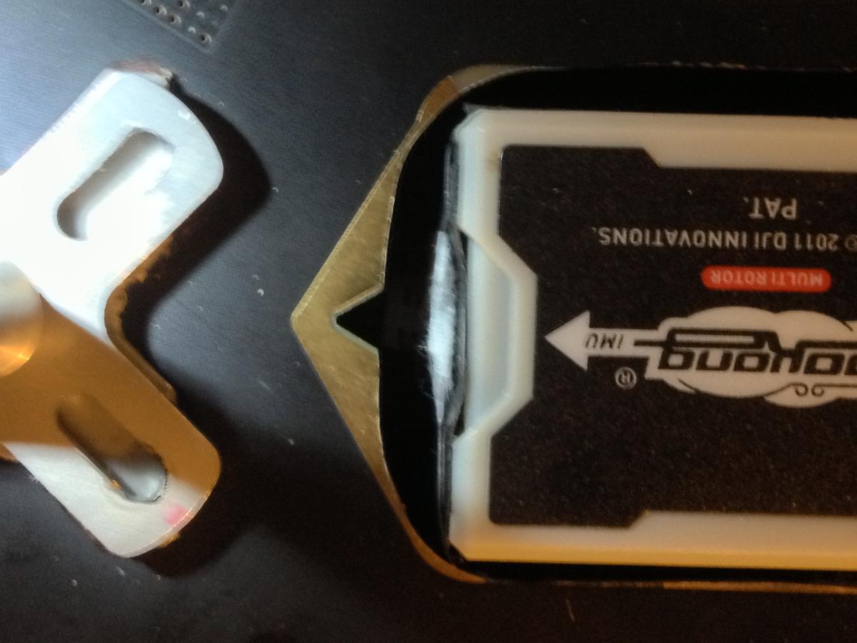

I was out today doing some testing with the pressure hole covered with surgical gauze. With my vertical gain is at 180 on the S800, so far it's holding altitute very well. I gave some aggressive movements with no change in altitude. Wind was about 8mph.
To install I cut a small 2 layer section of the gauze and used some electical tape to hold it taught over the pressure hole. The gauze seems to provide a nice buffer to any wind entering the frame.

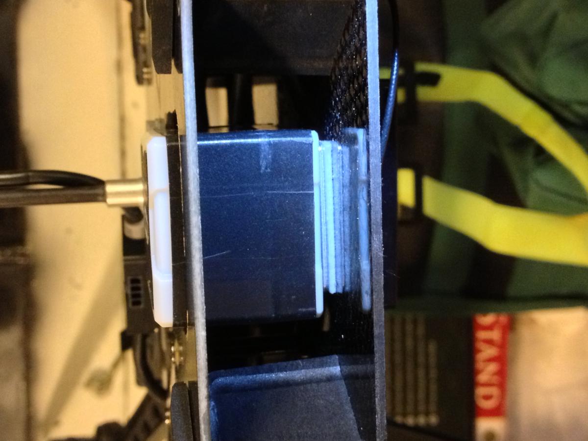

I was out testing in the air today for about an hour and had rock solid position hold with the pressure hole covered with gauze. My WKM is mounted in the defined location on the S800 but I used the red 3M tape with an anti-vibration plate (http://www.amainhobbies.com/product.../207389/n/Skookum-Anti-Vibration-Mounting-Kit) and than another layer of 3M tape to hold the WKM. So far this has worked really well. Hopefully I get some more time this week to go out and record wind speed and get some video of the S800 holding position.
View attachment 12654View attachment 12655
