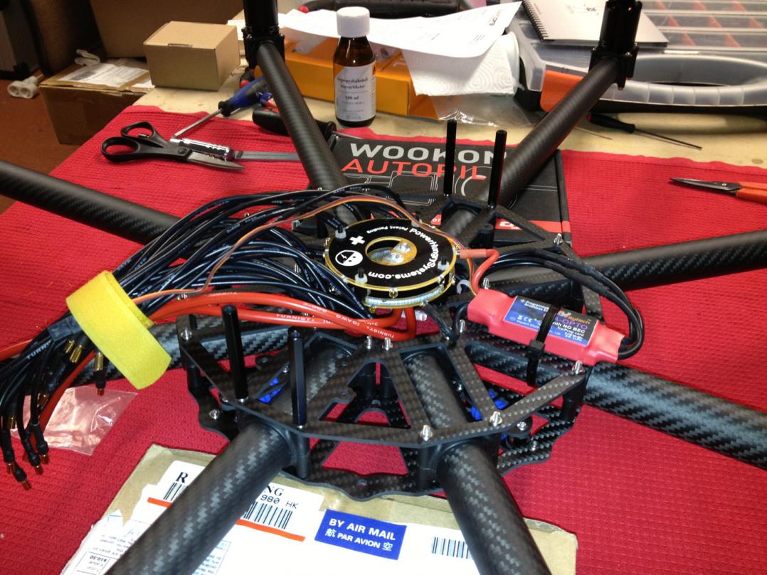

The frame arrived and I managed to get it built. Quality and instructions were up to the price, i.e. very good.
To mount the Power hungry board I needed some plastic standoffs, screws and bolts I had left from my Mikrokopter/Droidworx AD-6 build.
The power board came with a few standoffs but not enough to mount it. I would like to see some above mentioned screws and bolts for mounting as well to come with the power board kit.
The Kopterworx motors fitted the motor mounts great and they have bullets soldered in, so the only thing I had to solder was the bullets to the Maytech ESC battery wires. Maytechs already had bullets to motor wires soldered.

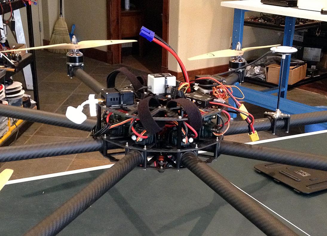

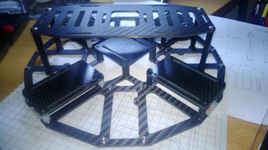

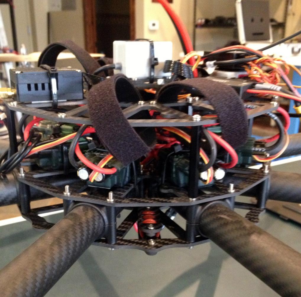

I have another top plate in addition to the one the ESC is on in the picture. The first picture on the left is mine. The other two are examples of how the second top plate has been mounted on top of the first one.
I only have four 550mm aluminium standoffs to mount the second top plate and all the Wookong-M stuff and two 8000mAh 5s batteries come on top of the second top plate.
I wonder if the four standoffs are enough to support all this weight and to make the second top plate flex free. Besides I only have one battery plate, the one provided with the frame. Should I have another or try to mount the batteries directly to the plate? The structure gets very tall when all the three plates and battery plates are installed. Any opinions/ideas?
