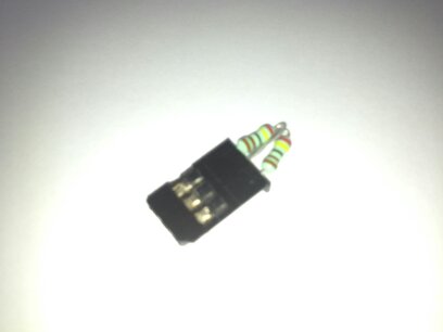

Cool. Beta 1.2.0 looking good. Get some 2.5kohm resistors.
Sent from my GT-I9300 using Tapatalk 2
