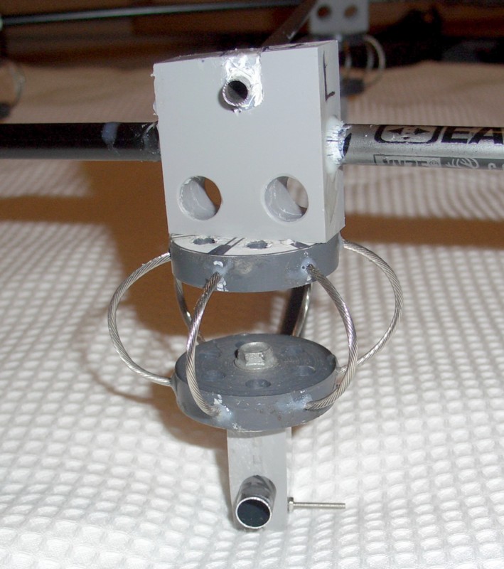

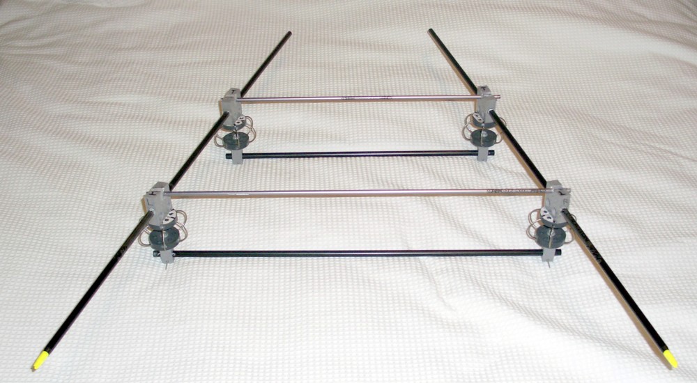

Thank you indeed. I have had a look at the FixHawk and it looks like it is well manufactured. I am going to ask RCtimer about its compatibility with the V8 octocopter which I have designed and I am building. I have experimented with several types of anti-vibration mounts for my camera and I found that the wire mount I made are the most satisfactory (see
). So I decided to use 4 mounts of this type on my new octocopter, as you can see in the attached photos. The bottom two cross tubes will carry the platform and I will add on it a smaller mount for my camera A lot of work and not so easy, but worth it.

Yes the FixHawk / Pixhawk is a very professional system that is well suited to high end pro aerial photography rigs. It's a system you can grow into.
Interesting stabiliser rig for sure! Thanks for sharing
