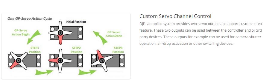

I recommend that you take advantage of the GCS airdrop feature utilizing a conventional servo to release a payload suspended by a drop cord...... as per this feature of GCS for PCs..... see attached image.
remote landing and takeoff imposes a tremendous control handicap... IMHO.
