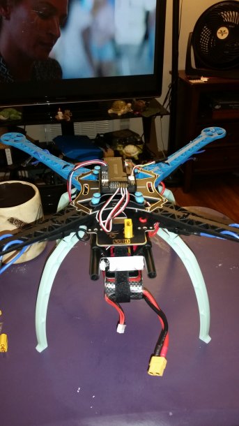

Should i put strink tube on these wires?

I would bundle those wires up and put a zip tie on them. That keeps them out of the way and looking kinda neat.

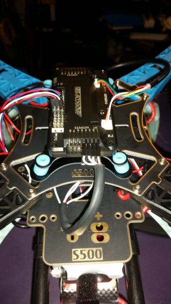

So theres these to different power plug connections here and i will be soldering a xt60 but can u also put on the other kind for the left one and be able to use two batteries at the same time?

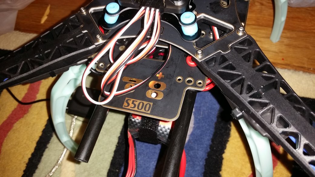

I think I when I solder the connector on the top what do you think about that

So do you think I really need to remove the ground and power from the other connectors for the ESC

You can't run 2 batteries at the same time and plugging them into 2 different plugs. You will burn something up on your quad. You have to use a parallel connection to use 2 batteries. The plug that you have soldered onto your PDB is ok just use the parallel connection and connect 2 batteries if your system will handle that much power.

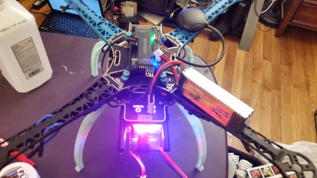

What do u think about this... i removed the extra cables for 2 - 4 just not sure where to pit the cables

You know the three wires that plug into the apm for each ESC the signal and the ground and the power people say only one power needs to be connected and to remove the rest of the pins so only the signal is on the rest of them I was looking on the APM website and it even suggested doing that even if the ESC use are linear

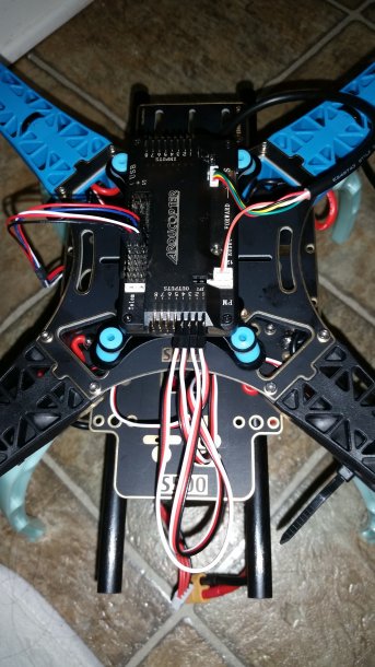

I did it. Im testing the power n my apm and leds r working yayyyyy
