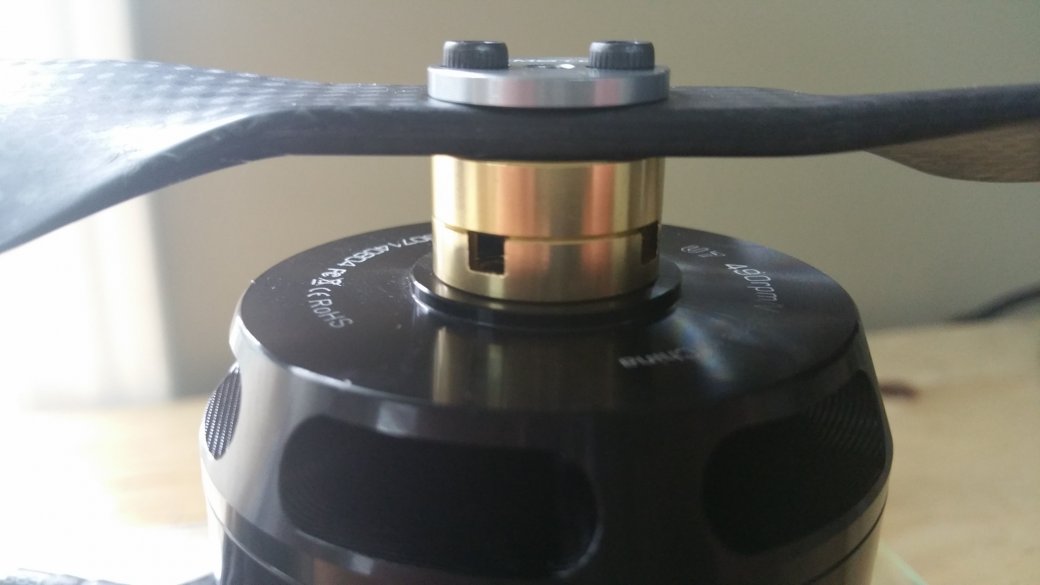

I use the tmotor washers on top of the props. See pic attached. Forget about the hub balancing. Try getting these centered properly. Impossible. The kde ones were worse because they we larger in diameter. The bolt holes in them for the m3 screws need to be a much tighter tolerance if you ask me but I don't know that it creates much vibration as it is centered on the motor axis. View attachment 26087
