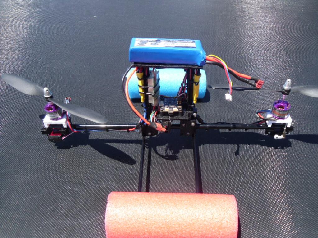

then theres me...... carrying on from bottle copter http://www.youtube.com/watch?v=AxNHACgAi5A , decided to have a good crack at the bicopters and see if i can refine things - i am a believer of having the mass over top of the motor pivot point, sort of like balancing a broom stick vertically with your hand, constantly unballanced, but allows a very dynamic control (dosent try to self level during forward flight
go my "build on" today and came up with this....

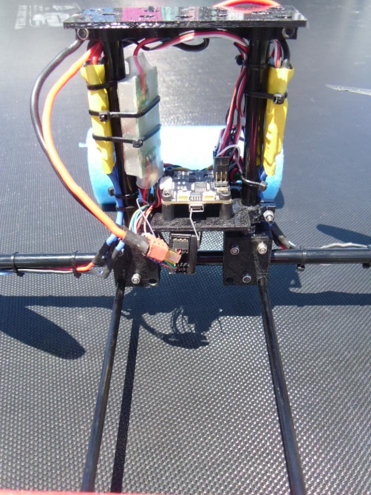

1 length of 10mm by 800mm carbon tube, and some PLA plastic parts made last nite on the printer
all up weight 697 grams, 400mm motor to motor, and the centre of mass is 55 mm above the motor pivot point.

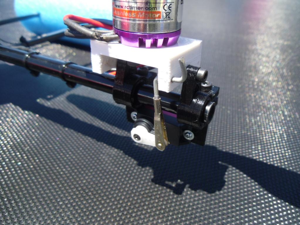

not happy with the pivot system, fairly sloppy, need a rethink - probably use the 10mm tube as the bearing surface next time, that will also help lower the pivot point, allowing me to make it more compact

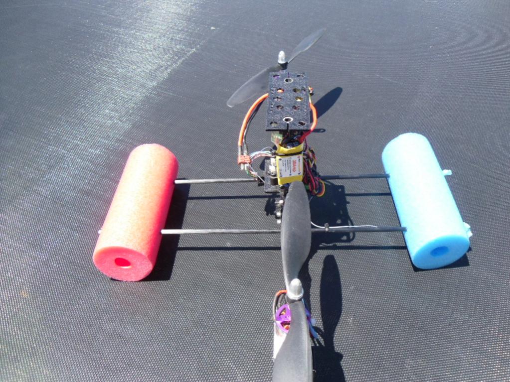

as usual the maiden flight and the breeze is getting up - the pool noodle landing gear (i am using it for orientation) dosent help as the wind pushes it around
needs tuning, flies ok forwards, but sways a little bit (tuning needs to be worked on) , yaw is fine, and i mixed some roll-yaw to compensate for the prop tourque, it needs to be brought back slightly
