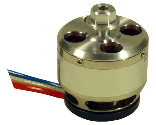

Orbit 15-20 is the best I have come across so far. Very powerfull and extremely efficient for 160 grams of weight.
anaka
hi cinerebel and redridinghood, this motor really looks different than all the rest
i have a question now, what abouth energy consumption? does it lift so much weight with the same amperes of an MK3638 or similar class motors? or does it need more power?
the expense is more than the double of MK ones so if this motor has the same energy consumption but lifts 3.2kg and is dynamically balanced and hand made, so very well checked before to sell, this price can be reasonable
one more question, on the link of plettenberg there is no 15-20 engine, it stops at 15-18, is this a particular version assetted for multirotors?
