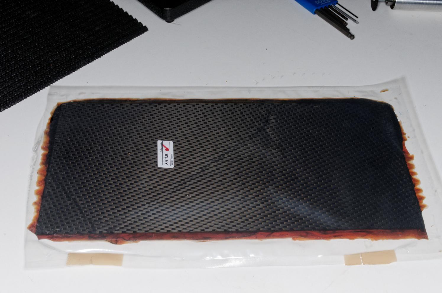

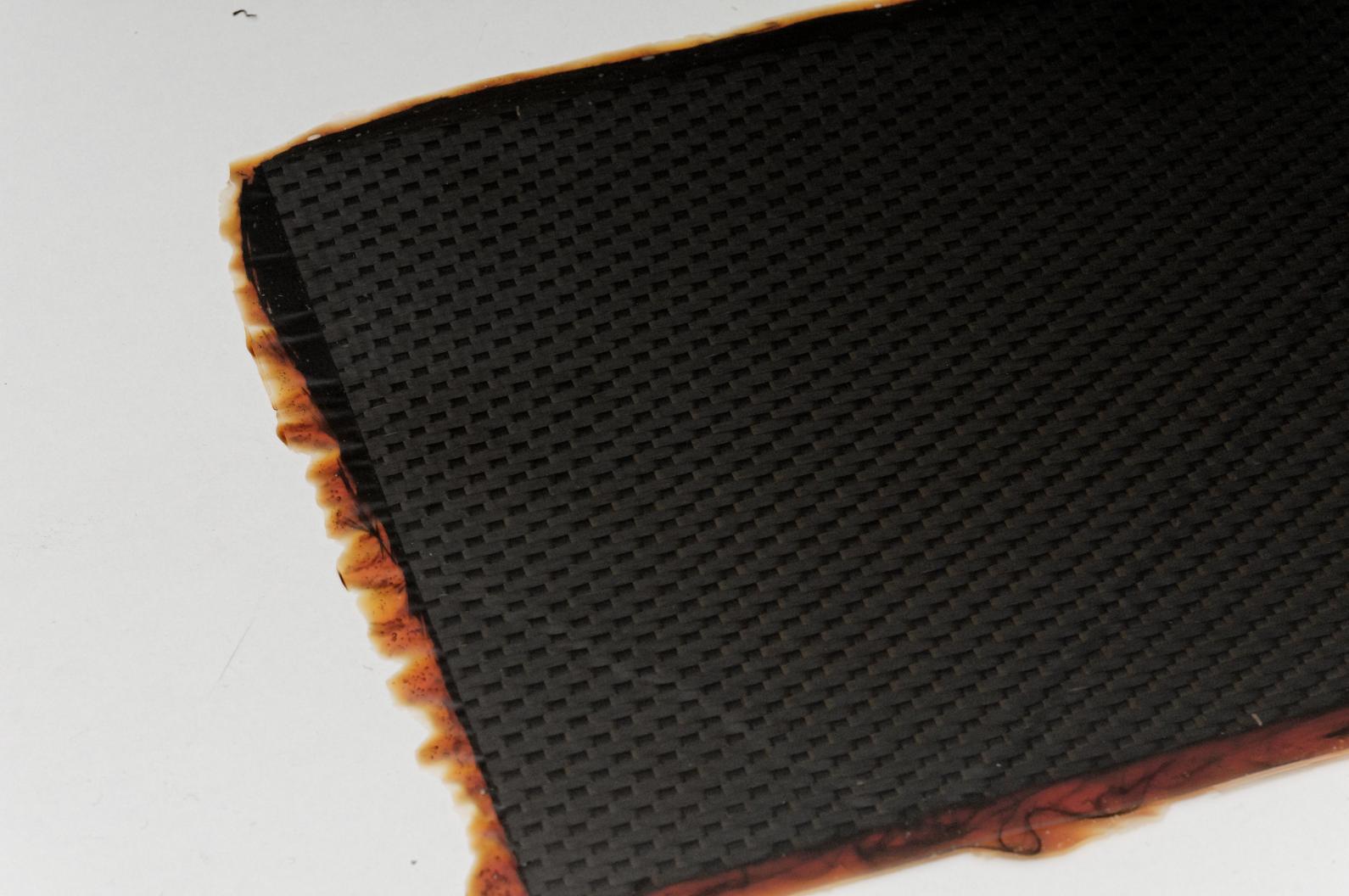

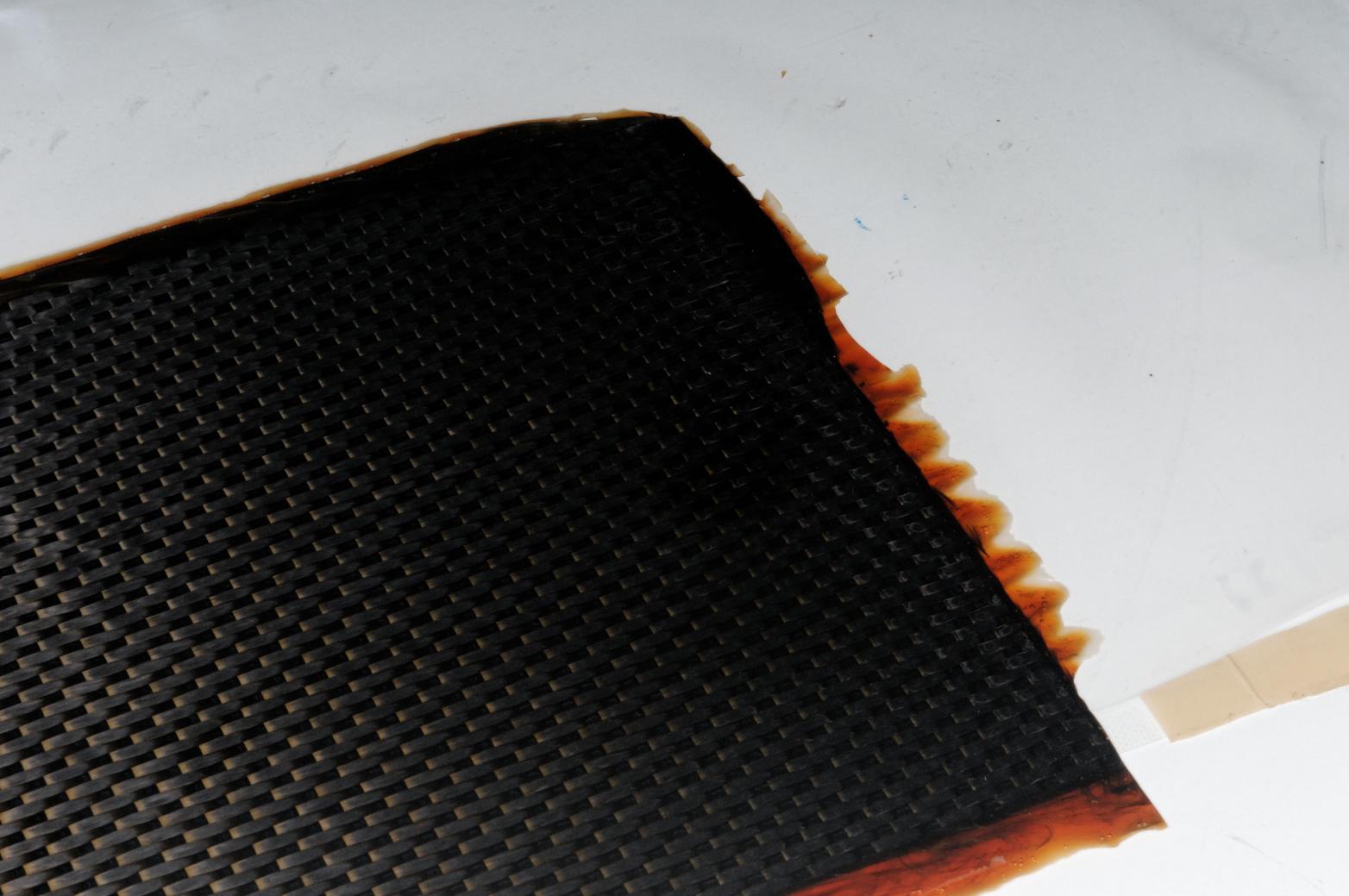

Images attached - difficult to capture the real-life look since I had to use flash and it has picked up the highlights.
I've also bought from http://www.carbon-team.de and http://www.carbonscout-shop.de/ but the tolerances and finishes from both of those was "disappointing". On the other hand, these guys only do pultruded tubes, which is not the ideal - the pulwinded tube from http://www.carbon-team.de is a better option.
