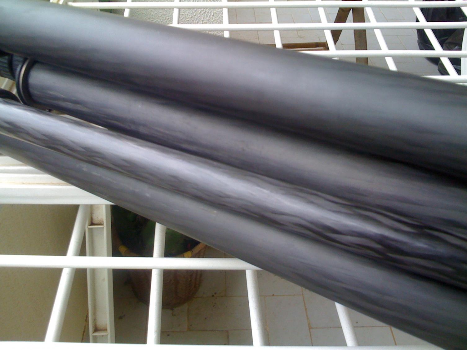

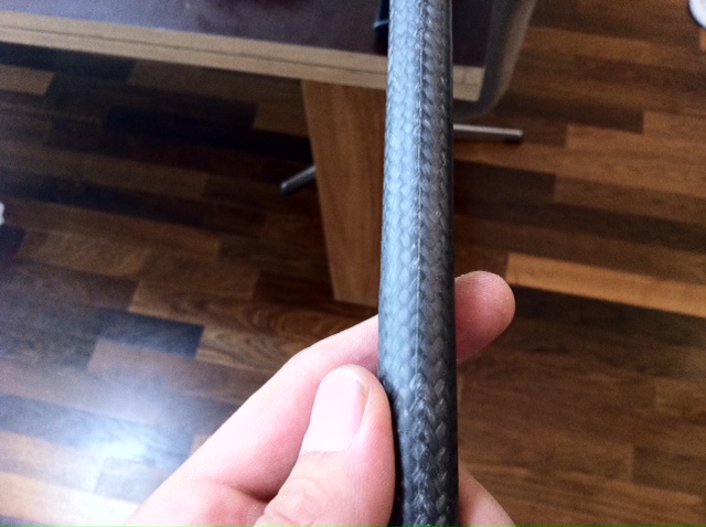

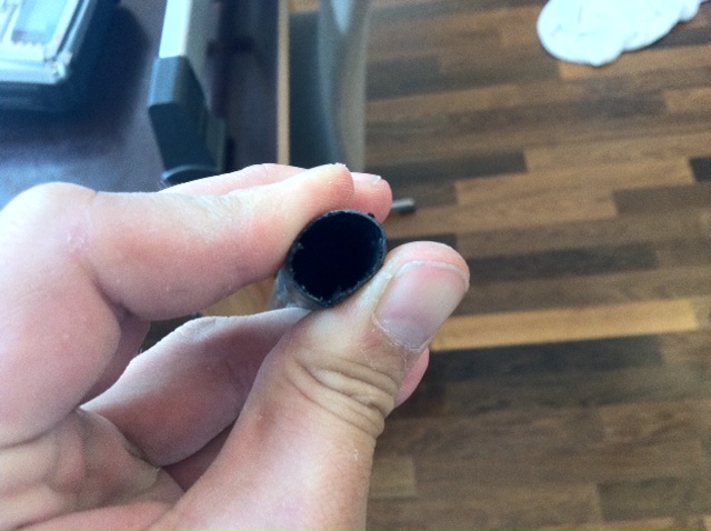

hmm must say the quality of the tubes that just arrived dont make me happy ! Maybe i expected to much. They are soft roughly cut on the edges and compared to the booms of the AD just not nicely finished. But maybe thats the sacrifice for it being formable ?

jes1111
Hmmm... they don't look very nice, do they? The top layer is gel-coat: you can sand it down with medium then fine wet-and-dry. After shaping you could spray with a standard gloss varnish.
BorisS
japp i will do that. I just feel a little cheated. The price is high and the end and beginning piece i will have to cut away since they are already thorn slightly. Whatever will start building some bending forms so i get them all the same shape and i will try it out.

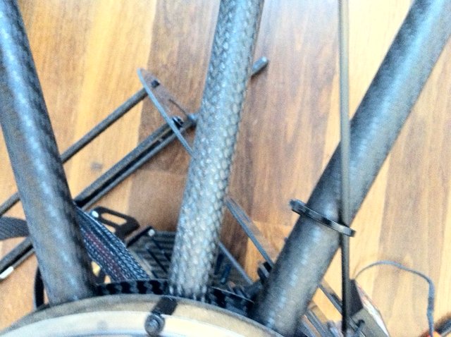

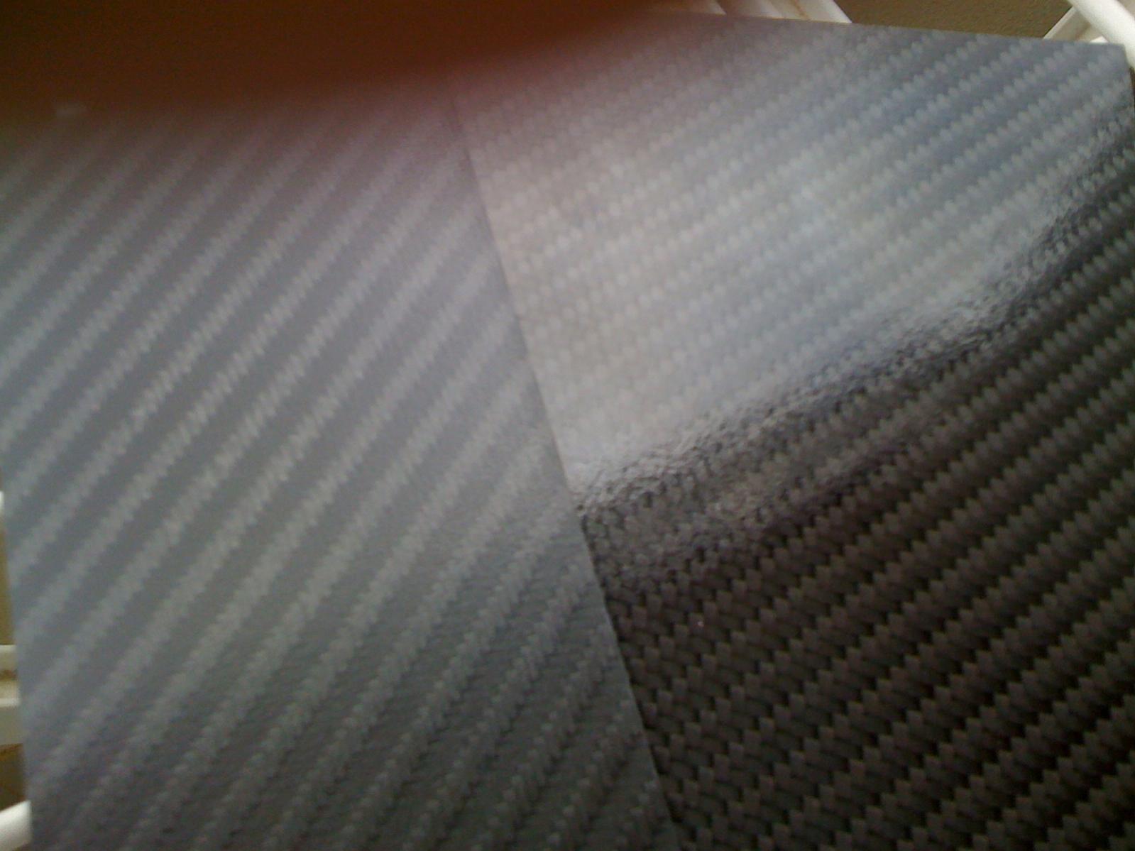

This is a (bad) picture of regular CF sheet (on the left) and thermoformable (on the right). Slightly different weave - but otherwise of apparently identical quality.
Second image is the legs of my Gitzo tripod (mega-quality pulwinded, with matt finish) versus 18mm pulwinded tube (second from the bottom - actually gloss finish but doesn't really show).
All from www-carbon-team.de

BorisS
Strange one the Thermosheet looks a lot beter than the tube. I hate going through complaints back to companies but in this case i might just do it ! Thanks for the pics !!!!!
