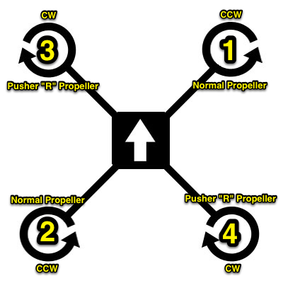

If it's flipping take the props off. Then throttle back up a little and make sure that you had the props on correctly, and that the motors are spinning the correct direction. The air should be getting pushed down.
attachment.php
If the motors are not spinning the correct direction then you need to swap two wires of the three from the ESC to the motor. once you get the motors spinning correctly, then tip the quad and verify that the lower motor/motors spin faster. If all is working properly then put your props back on and go flying! :)
