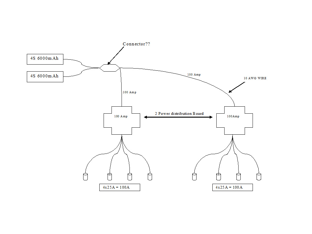

In my project i will be using 2 distro board.Each will power four motors.The max amp stress of the board will be around 100Amp which can be handled without a problem.
Now, the problem is the MAIN CONNECTOR that will power all these from the batteries in parallel.I have made a quick draw of my configuration to be more clear.
That main connector should be able to provide the 200Amp without overheating.I have seen many configurations using deans connectors.As the deans can transfer up to 50 amp,that is a
disaster waiting to happen.I am thinking to use the EC5 connector, but even that, the supported rate is 120Amp.
Droidworx site has made an alert note (a failure reported) about these connectors used on heavy amp-hungry multicopters -> http://www.droidworx.com.au/conceptx.html
What kind of main connectors do you guys use for your setup?
I have found some Anderson connectors that are for solar connections and can deal with these amp`s easily. http://www.andersonpower.com/products/multipole-sb.html
Also how can a 4S battery at 6000mAh and rated at 25/50C can deliver 150A (6*25) constant when the battery connector (HXT 4mm) is rated for up to 93Amp???
Any advice will be appreciated.
Let me know if i have calculated something wrong here...

Even if i join the 2 power boards the main connector amp will still remain the same....the load to the main connector will not be less.The question is whether the main connector will stand the total load?

I agree with homer911 - a connector for each battery. I'm using 4S x4 - each one has Anderson 45A Multipole connectors - they all feed to a single "PCB" with 0.5mm copper - the whole setup will handle 200A WOT, no problem. I hate bullet connectors, Deans, EC5, Traxxas and all those others - their current handling claims are exaggerated, I believe. Anything from Anderson is credible.
BTW - if you study the Anderson documentation carefully you'll see that many of their connectors have two versions of the contacts - "high detent" and "low detent". The default is "low detent", but the "high detent" ones have a much more positive "lock and hold". Mouser.com has both but you can't tell from their description which is which, so get the right part number from Anderson. The 45A Multipole connectors also have PCB contacts so you can mount the aircraft-side connector straight to the PCB instead of having a wire from the aircraft-side connector to the PCB. Again, be careful - there's a 25A version and 45A version - feed the right part number to Mouser's search box.

That can be the one solution, one battery to each board.Although i am not quite sure if in the event of a one battery failure the one distro would handle the whole load for delivering power to the second one.I will be using these boards http://www.kkmulticopter.kr/index.h...selected=Center&sn=power_board_octo&id_no=120
Jes1111, do you have a picture of your setup?But one the other hand wouldn`t be easier and safest if i use a heavy duty connector from anderson?

That KK board claims the copper is 1.0 µm thick. Obviously a mistake - try that number here and see how much current it would handle! See what I mean about "credbility"! ;)
Two or three problems with using the big Andersons (like the SB series) -
- you shouldn't really put more than one wire into the crimp - the rating is likely to compromised.
- to crimp the SB-size contacts properly you really need the big-*** ratcheting crimp pliers - very expensive.
- you don't really want your batteries permanently wired together - very inconvenient if one dies and you want to swap it out of the pack.
- have you seen the size of the SB series? It's HUGE.
- the cable from that connector to the board(s) would also have to be HUGE.
That's five! Oops! :)
P.S. If one battery fails catastrophically then you'll probably be falling out of the sky anyway so I wouldn't be worrying about ampacity at that point ;)
EDIT: corrected the link - brain must have been in neutral
