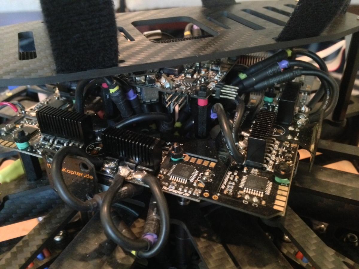

7. Don't use motors that have a collet adapter or pop off adapter for the prop, balancing will be a nightmare and it will be easy to bent the shaft.
I'm new to MR but been flying for years and have realized that the "rules" are different even though a lot of the equipment is the same or similar. I've never heard this before and just want to verify what you are talking about so I posted a pic below... Is this the type you are referring to? I've never had issues in the past but again I know things are different. Is it a big issue to use them? If so are different ones available that will work with the Park 480's or are they motor design specific? Can't change motors at this point, I've had too much frustration dealing with esc issues (btw, Eflite "Pro" esc's are not compatible with most MR FC's). Thanks!

jwk, you can use them of course but they can have a fair bit of vibration, multiply that by the number of motors and the vibration levels may end up higher than is ideal, especially is the shaft is long, shortening the shaft can help.
Pete
