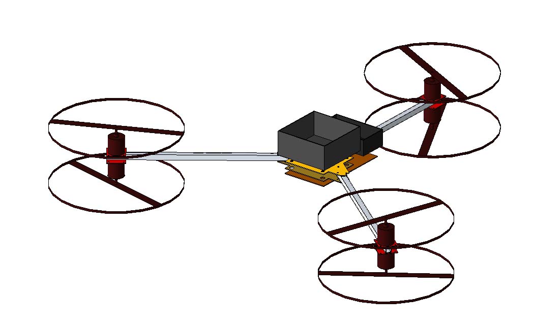

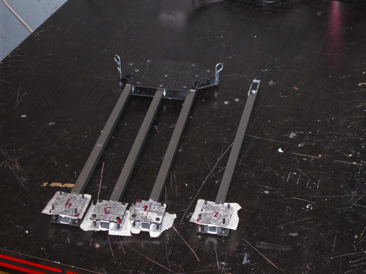

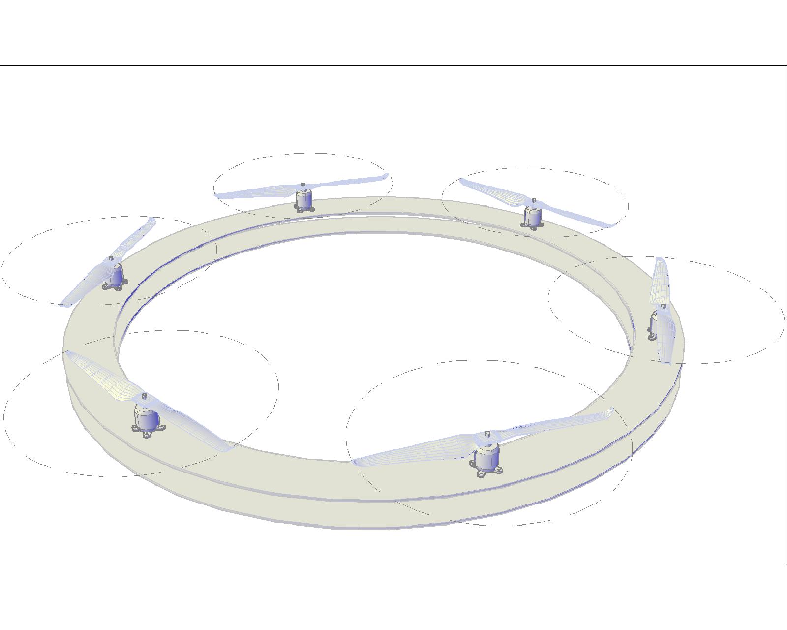

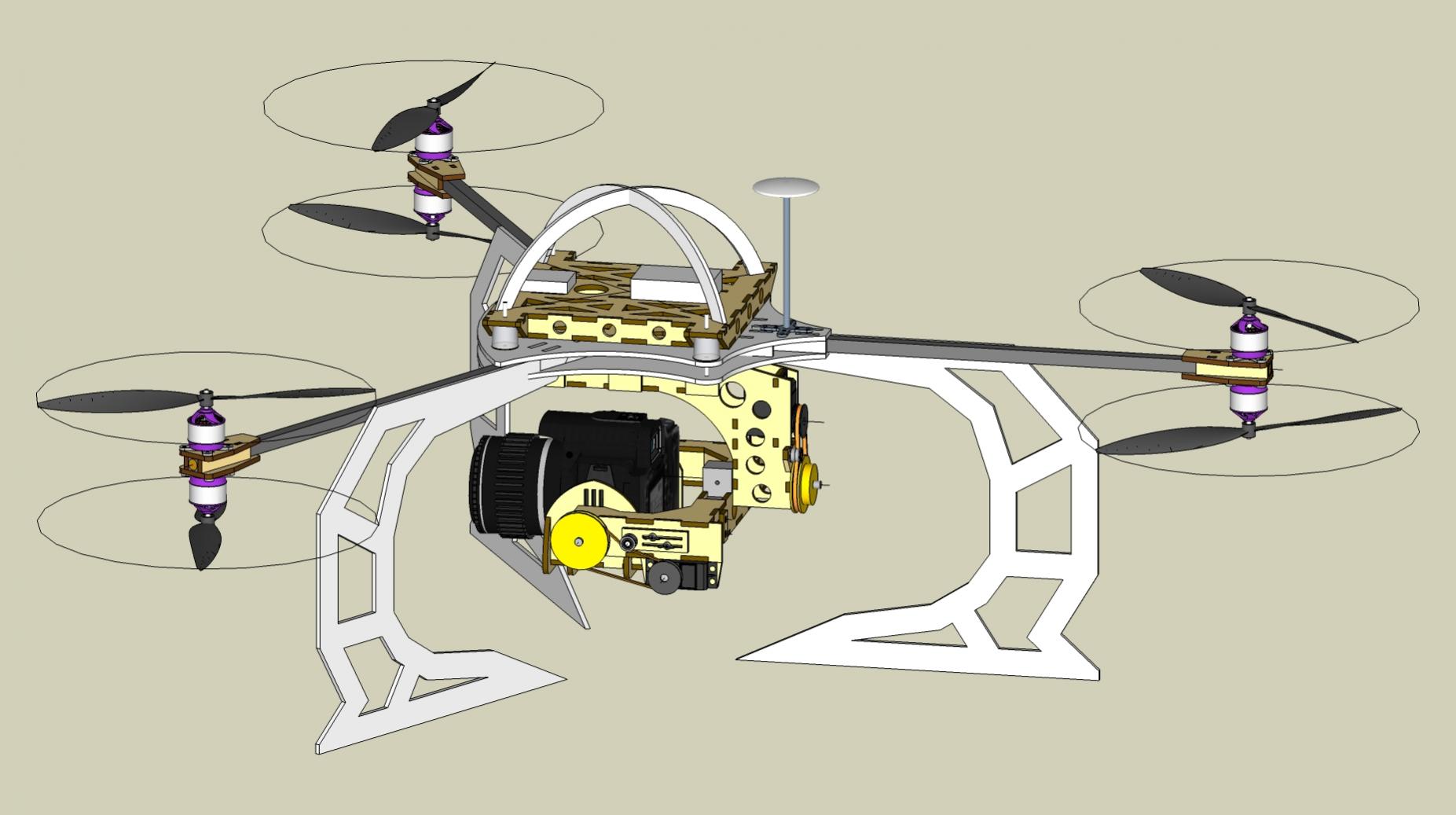

Here's the original plan. I haven't drawn the landing gear 'cos they are finished allready. More or less.

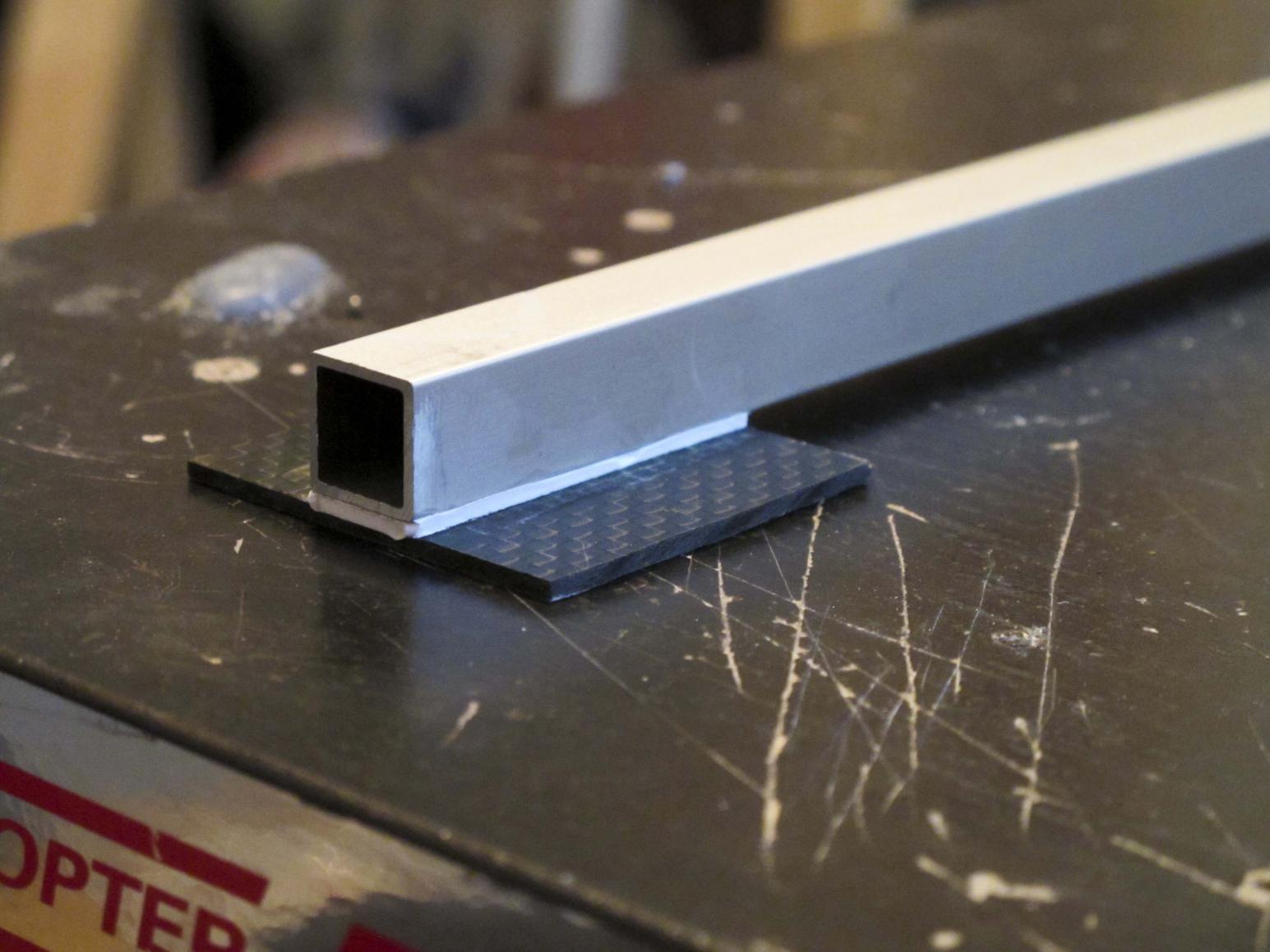

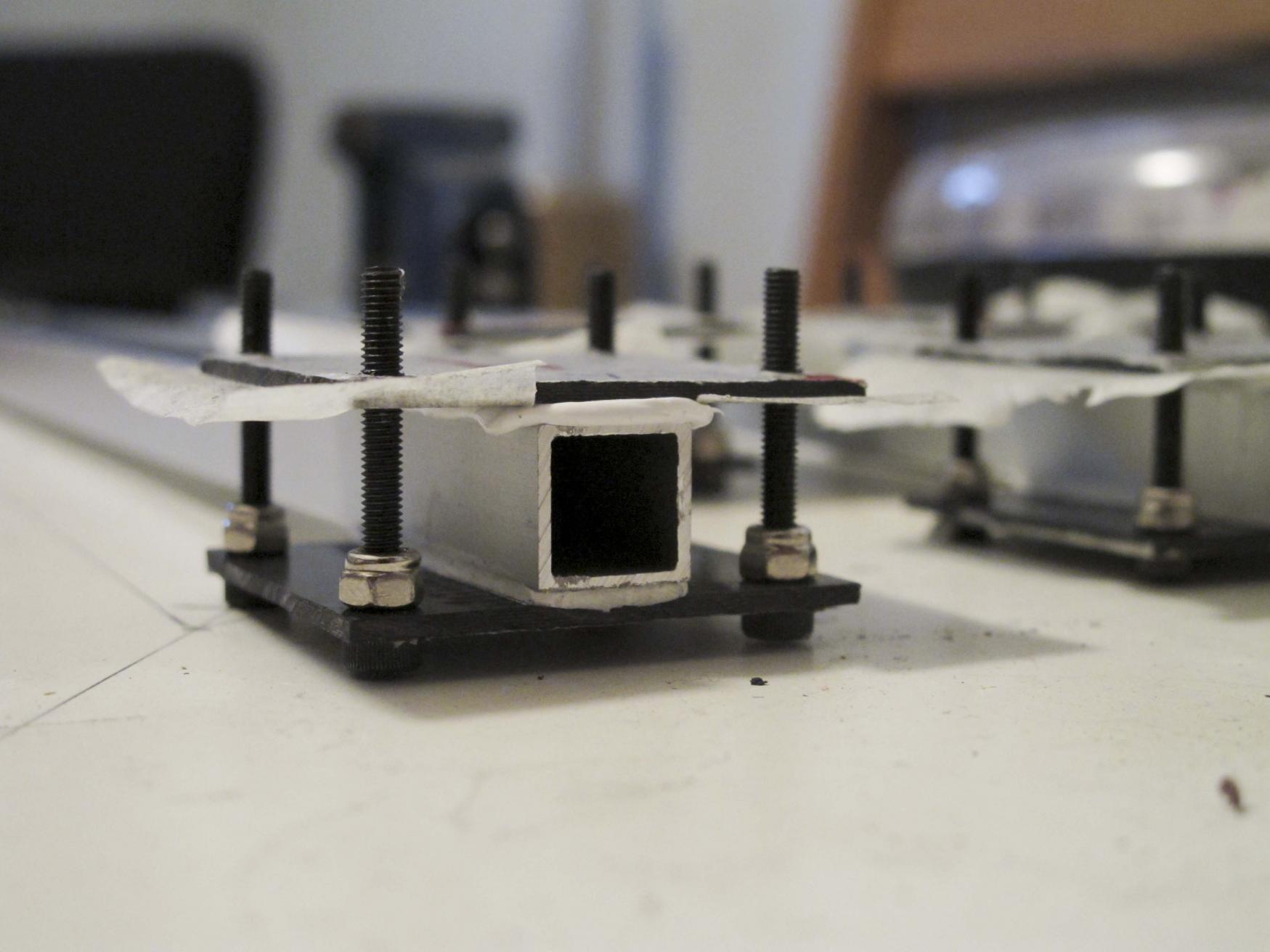

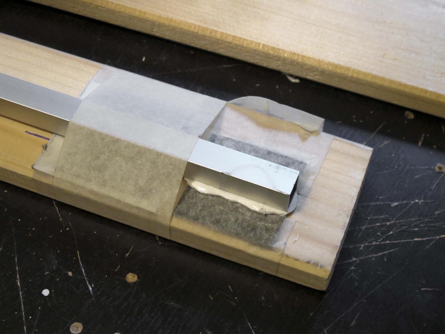

Motor plates are glued with elastic (silicone?) glue to damp at least some of the vibrations.

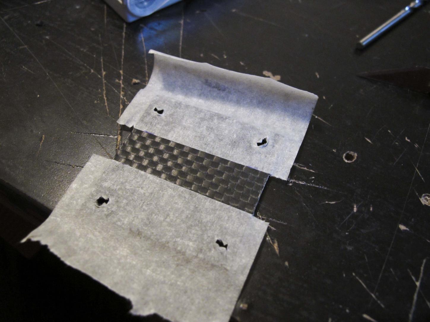

Marking tape to border the glue and peel of the excess

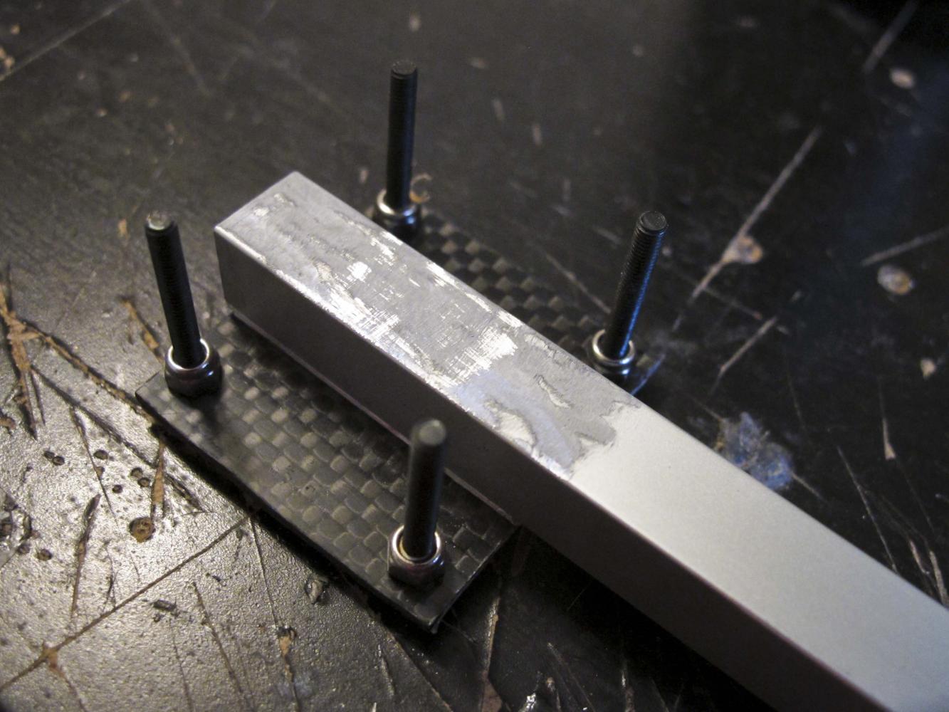

The fix to make 1mm space fot the glue between motor plate and arm.
Screws are in place for glueing the opposite motor plate exactly in the right place.

Great project keep us informed how its going.. great to here the motors are going on a Y6 my favourite config
The opposite motor plate glued

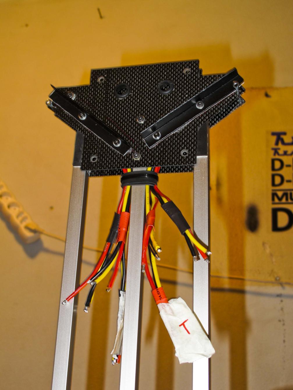

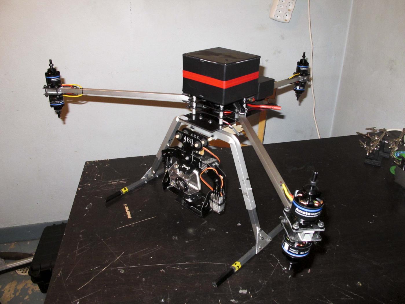

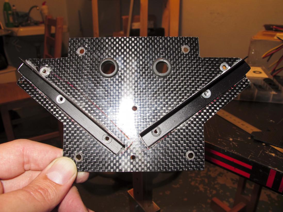

I had to reinforce the center plates with some aluminium profiles. I might have to redesign the center plates. I think they are too weak, only 1,5mm cf. But we'll see that after the first flights.

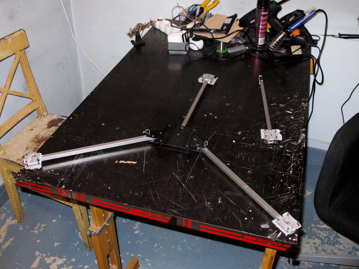

Motor to motor about 70cm.
I made one spare arm as well

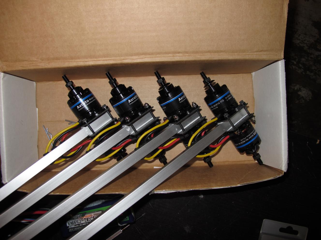

And the motors! Unfortunately I didn't have my camera with me when I mounted them. The process of putting the wires go through the 12x12x1mm aluminium arm was not easy. But I'm happy with the result!
Thank you all, I'll get back to you soon,
-Mika

Hi Mika, the build is looking good. Also, good idea to make a spare arm, it will be quick to replace if it gets damaged.
Gunter.
ahhh, it warms my Jersey heart to see those motors already being put to good use.....good luck with the build Mika.

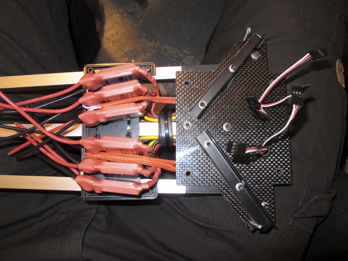

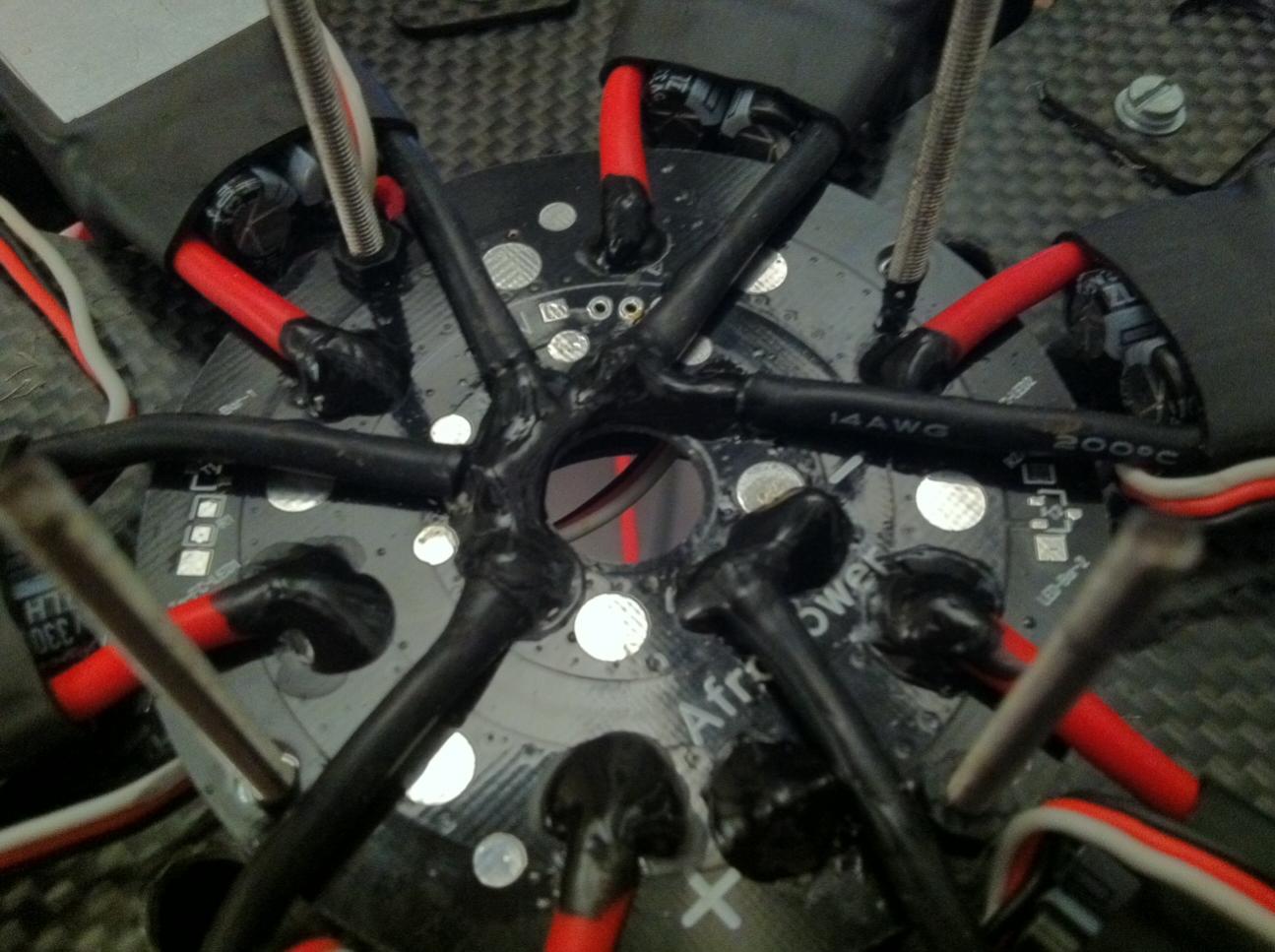

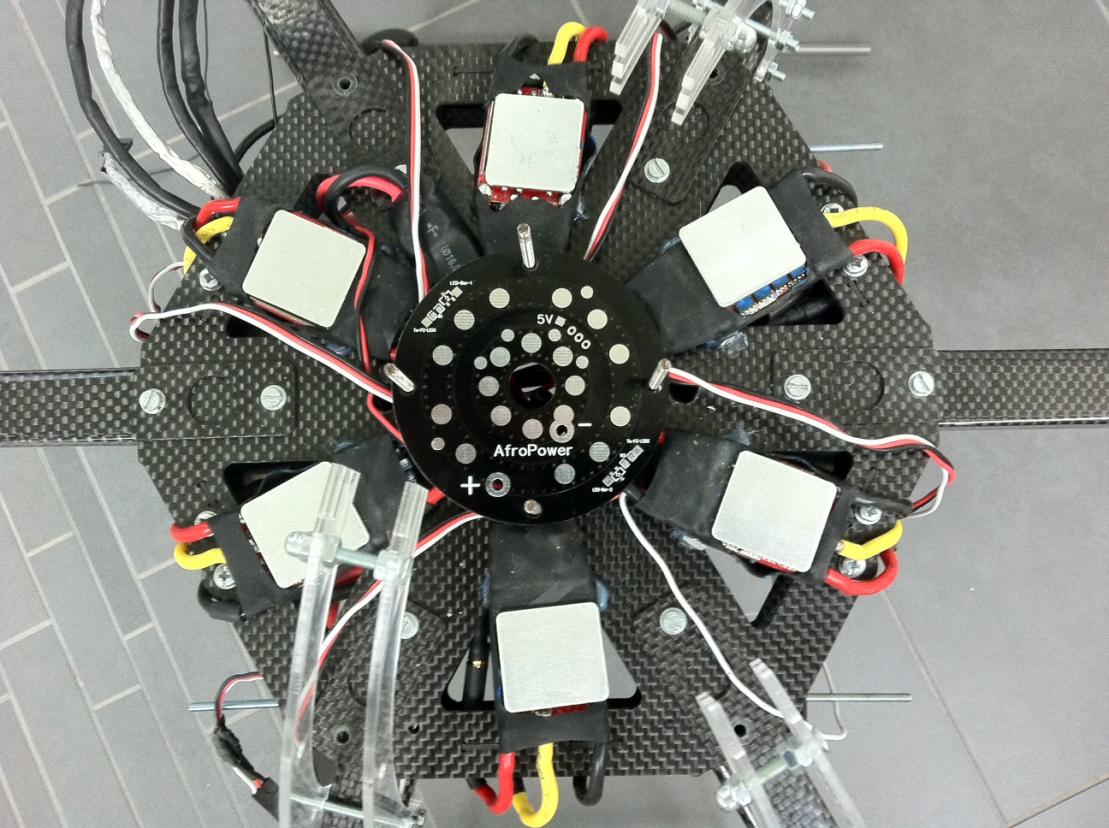

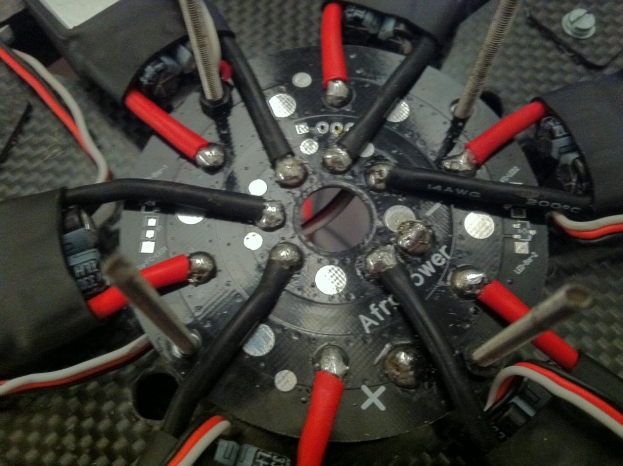

Ready for ESCs

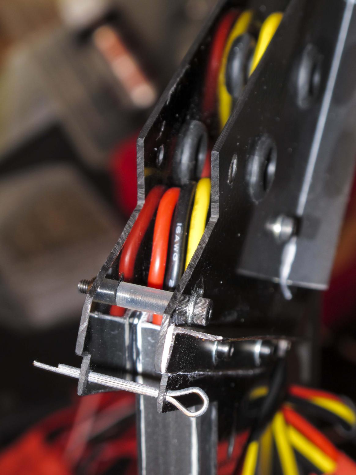

The two front arms lock with a safety pin.
ESCs in place.

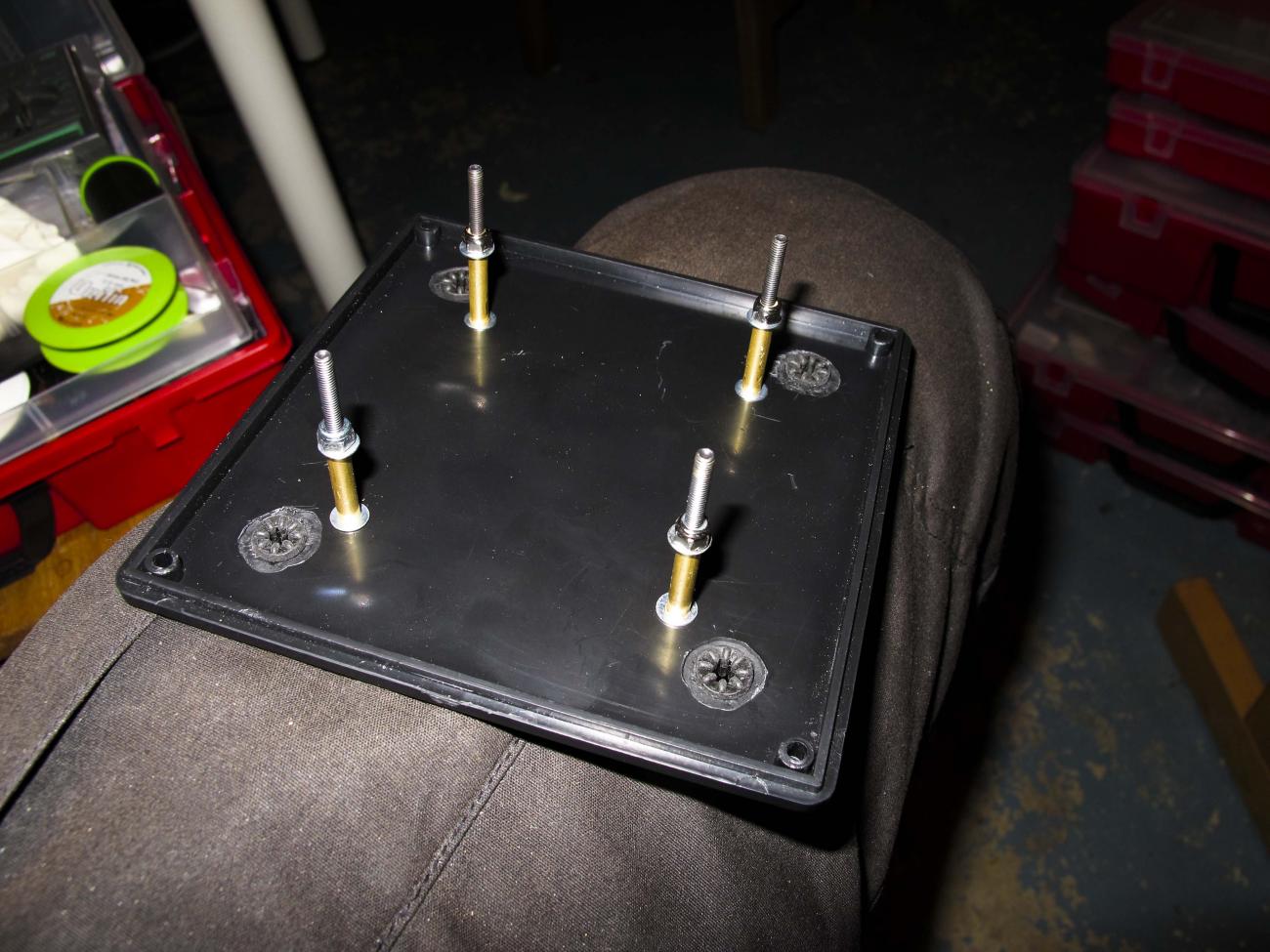

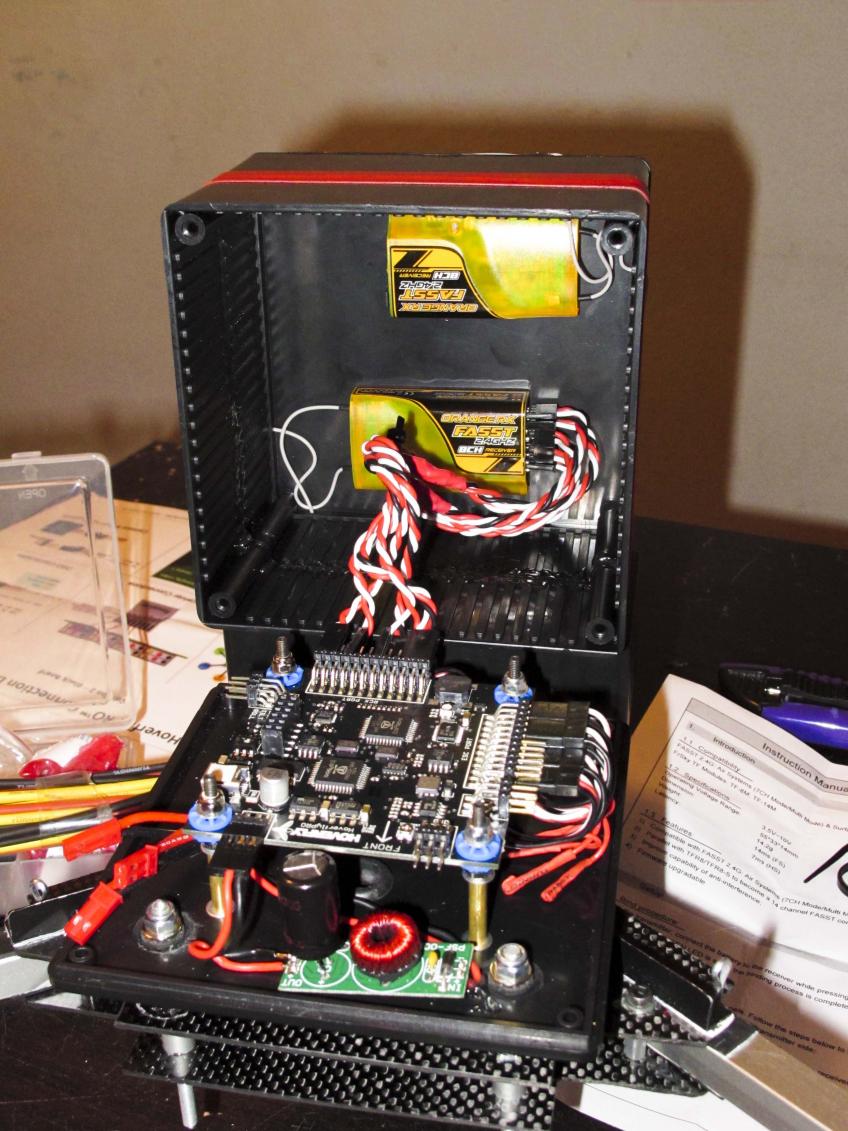

HF Pro board will sit on a bottom plate of a polycarbonate box
Board installed. Only one red cable going into the board from the ESCs. I might ad a BEC later to do the job. In front is a modified LC filter from dpcav. Changed the capacitor to bear 4s lipo voltage. ESCs are boxed with front and back wall off for ventilation. We'll see if additional holes are needed to provide enough cooling.
