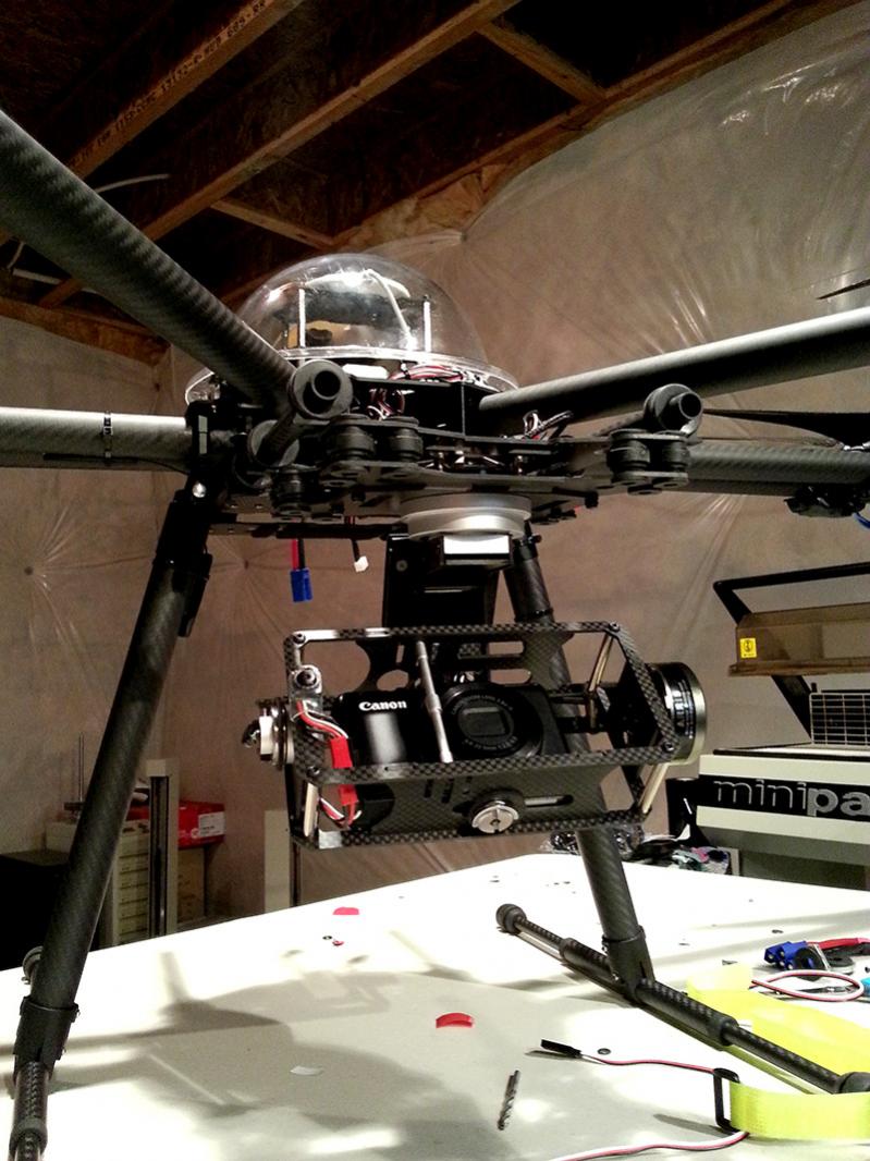

Got my Zhaoyun installed on my Tarot T960 last night. The supplied plate isn't quite wide enough so each ring only has one screw. May order the new plate. I have yet to wire it up yet. I don't have a NEX camera so I put my Canon S95 in for fun. We will see what happens.
mediaguru
Alright I've had my first in-air test of the Zhaoyun. The video is completely bad. No jello but completely bouncing all over the place, mostly up and down it seems. I can post a clip if that would help anyone with a diagnosis. Here's the setup.
I've put a Canon S95 in the Zhaoyun since I don't have a NEX7 or 5 yet. When I put the camera in, I make sure it balances center, however it is leaning back since it is a bit heavy to the back side.
I've got the gimbal on a Tarot T960, forward on the rails with the batteries back on the rails to balance it out. That's cool. All balanced there. I can set the bird up on the cross/middle arms and it will balance that way.
I think perhaps the PID's and motor power levels are way too high since this is a smaller camera and the gimbal was pre-tuned for a NEX. The gimbal is making quite a bit of noise and vibrating.
Any advice is appreciated.
mediaguru
Forget the last post. The gimbal is made for the NEX. Now I've got one and it is MUCH better, but still some vibrations. No jello.
The 16-50 lens my NEX5-T came with makes the camera fall forward so it isn't balanced on the gimbal. The gimbal seems to handle it, but I wonder if that would help reduce the vibes if it was perfectly balanced. I'm not sure how I would counterbalance the lens.
