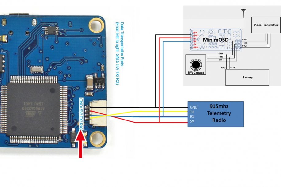

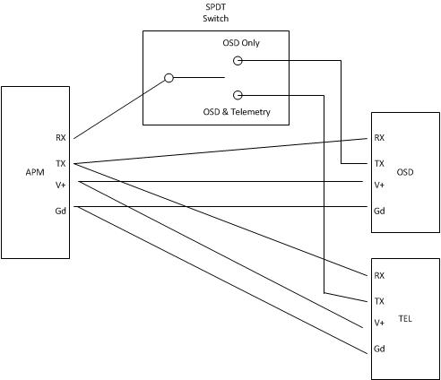

I still have not flown my Tri yet, because only as of today, I have finally solved the very last problem, that DID pop up.
The "No Mav Data" issue when running Telemetry, with a Minim OSD. Phew, What a hair pulling ordeal.
Telemetry works fine, but no OSD overlay. What it seems to boil down to is that all the schematics I have found on the net are incorrect, so I just made a jumper set of wires, and got it working. I also considered just using a standard "stand alone" style OSD, and ran across a guy who modded the old Remzibi OSD to work with the APM, to bypass modifying the code in Mission Planner. This was my plan B.
I may still go this route on future projects.
http://diydrones.com/profiles/blogs/port-minimosd-to-remzibi-s-hardware
What this does is to bypass the APM's sensors in favor of others on a smaller version remzibi. Not cost effective, but a solution to the No Mav Data thing.
Now just a few more things to button up, and attempt a flight. I have been working on this thing for a year, and every time I run into a snag, I find something else I over looked that could have caused a fatal crash. This time I noticed more cable problems, as the "Mini" APM I have installed in this thing, has very delicate cables that are easily damaged by multiple plug ins, and unplugs, and will easily work themselves out of their sockets with vibration once worn. I have a fix for it now.
So anyway, it will be in the air soon LOL. Like I said I am a stickler for details, and these things are expensive ($450 for this one) and they are very dangerous in a lot of ways, so I try not to over look anything.
Here is the correct schematic along with a switch to turn things on and off if needed. I will be in touch.
