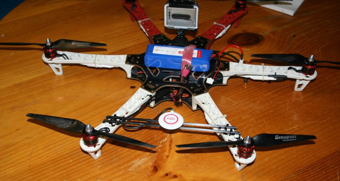

Ken, how about trying a flat plate between the 2 front arms, put the gps straight on top of the plate so that it's under the props. Just a thought!
Regards, Gunter

Finished fitting the GPS unit today, hopefully I'll have a good flight tomorrow.
I still have to do the compass calibration spinny thing first.
that looks like an great solution. i will be interested in what kind of results you get with the gps under the rotors. had never really thought of trying that, till i read about it here and now seeing it, it has me stoked to give it a go. let us know how your flight goes - happy flying
Billzilla
Thanks - It's held in place with a couple of small carbon tubes, it's surprisingly stiff and I also balance the props so I don't think vibration will be a problem.
The props are Graupner & so are plastic, so I don't think will affect the GPS signal at all - When I was setting it up inside the house the red light on the VU stopped blinking so it seems to have a good GPS signal.

Did a successful first flight with the GPS on, seemed it work okay I think.
It did wander around a little but nowhere near as much as without the GPS on.
