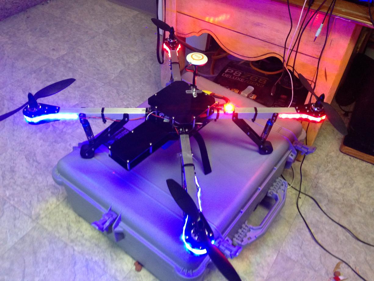

Well I'm planning on doing the maiden today. The only thing I'm unsure of is setting the gains and what to expect from them. For now I left them At the naza set default . I double checked directions the motors are spinning ... And made sure the propellers are mounted with the size number written on them is pointed upwars, which makes the blade twist pointed upward as I'd they would screw upwards towards the sky.. This is correct right??
All and All with 9 x 4.5 propellers, 4x iflight/ ipower 2217q 880kv motors , 4x next level 30amp esc, dj naza v2 with GPS, next level quad 650 mm frame ... Alot of wiring powered by 2x 45c 4s 5000mah in parallel !! My quad weighs in at about 6lbs!!! Which is around 2750 grams ! 2150 grams if I only use one battery.
Each motor is rated at about 1120 g of thrust on a 4s with a 9x4.5 prop. So I should have enough lift to get off the ground.... I think. !!! Lol
ill take some pics!
