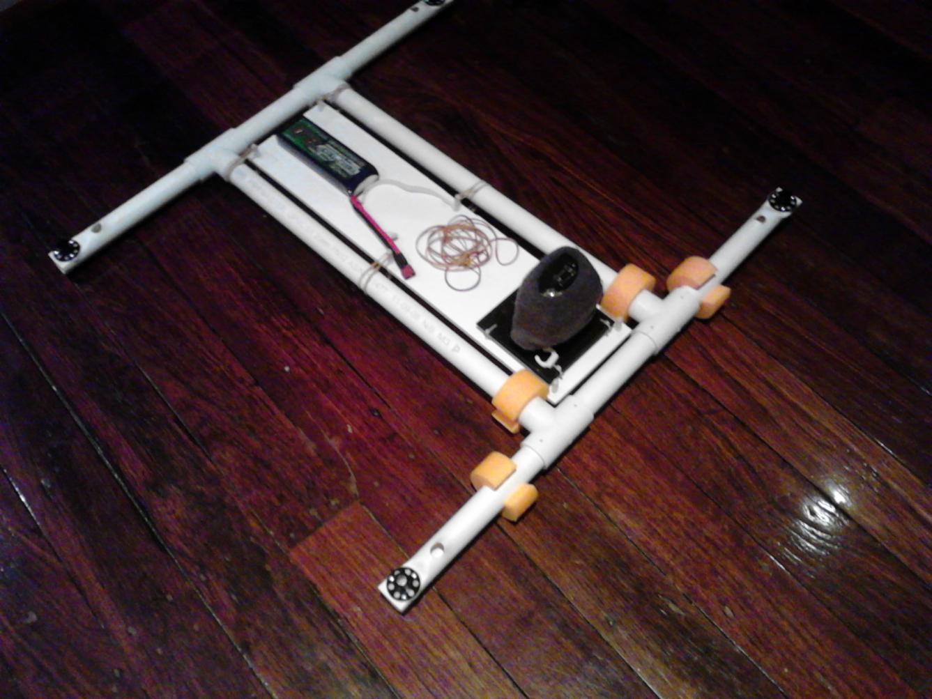

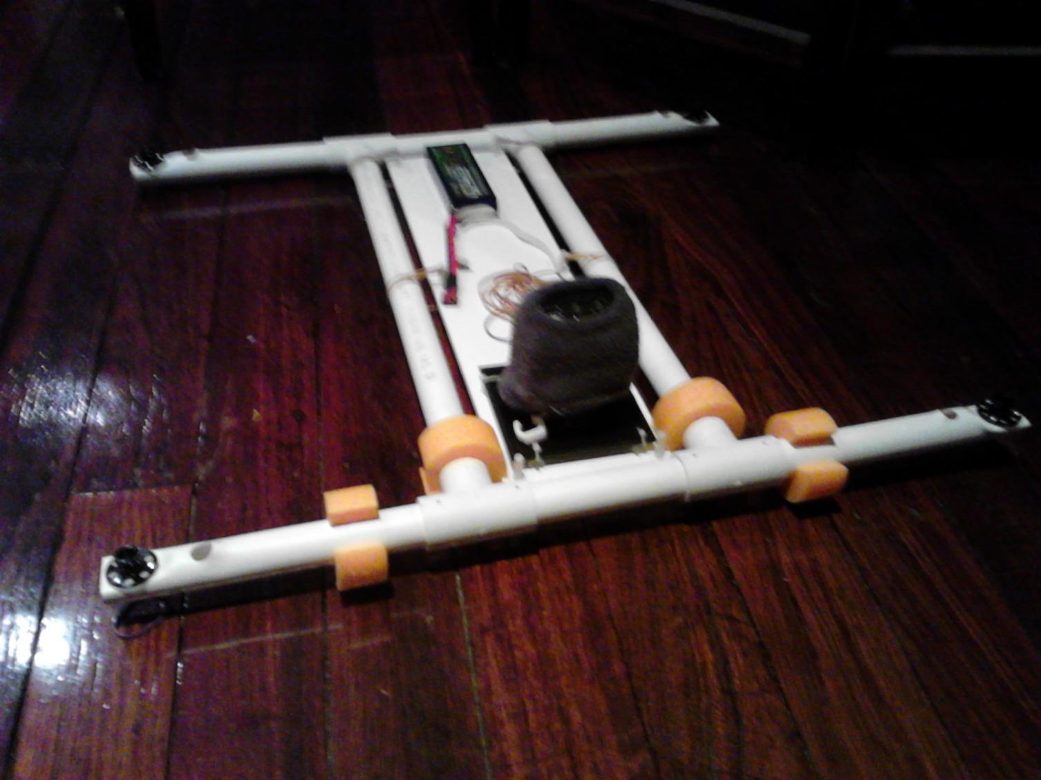

Hi Ive been trying to make and easy build H Quad for mounting my GoPro.
Obviously vibration is my main concern but I also wanted to be able to quickly dissasemble it for transport.
The frame is quite heavy but I am planning to drill some holes into it
I tried making the centre plate from the art foam that has the cardboard layer on each side. I attached the board using elastic bands however it doesnt look like its going to work. In fact the elastic bands seem to amplify the vibrations.
I will now use swimming pool "noodle" pieces to attach it in 6 places (similar to how I have done the front). I have mounted the gopro on 10mm silicon tubing but I can see that this setup is too stiff and doesnt look like its going to work either ?
Any ideas please...

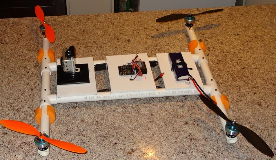

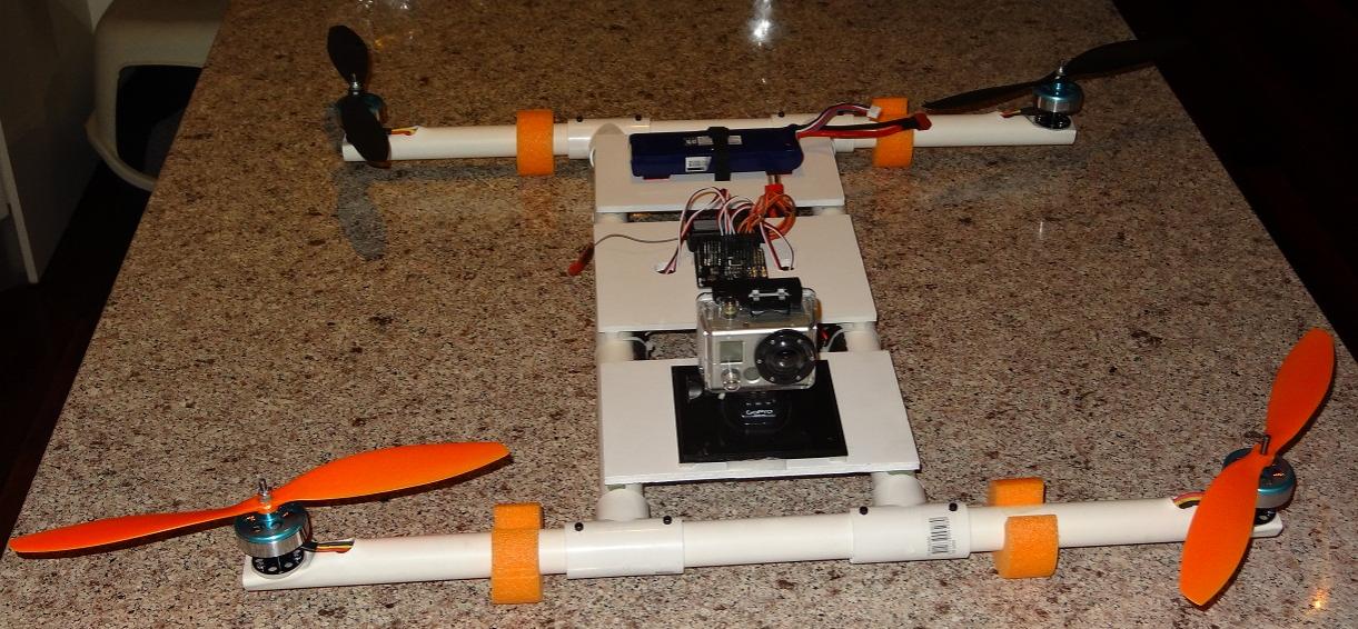

jbalat
Just an update... No it doesn't fly well at all. Will need to hook it up and do a vibration test to see what's going on..
jbalat
Another update.. Just got it flying !! After balancing blades and motors with the program above I still had some random wobbles. So I used the bypass filter in Multiwii 2.1, edit in config.h
I also moved the camera a bit more forward to get rid of the props.
