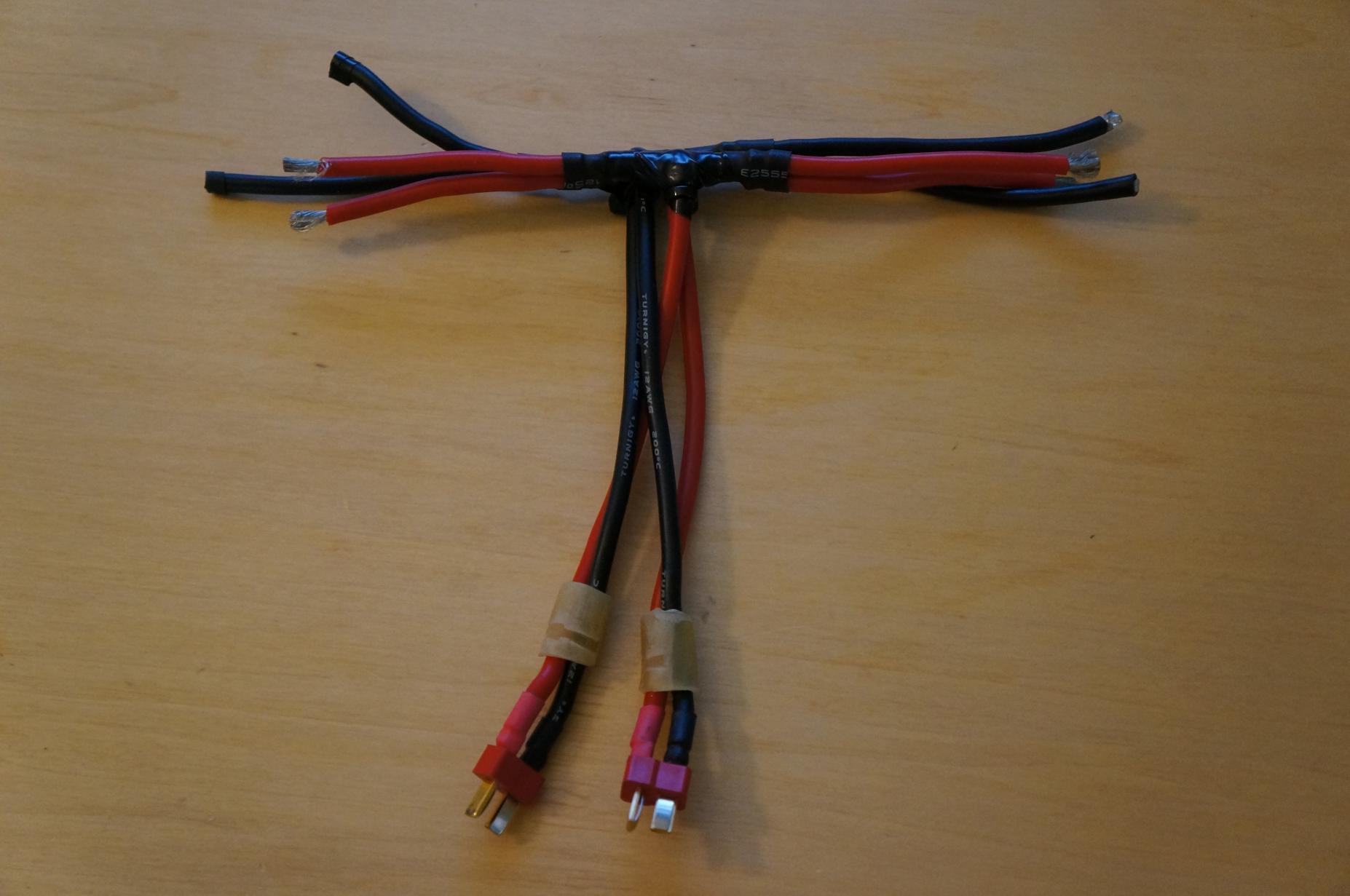

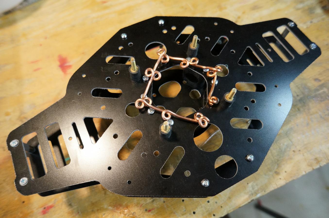

I've got a couple of the available boards on my bench and I'm trying to see what can be done with them but I"m also playing around with a new idea to get power from dual batteries to eight ESC's. What I've done is identified where I want my solder connections to be and have put a loop at each spot. There are also loops to the batteries and four loops for mounting studs to go through. The idea would be to make a positive and negative one of these and then stack them. I've also thought about sliding a short piece of silicone surgical (a.k.a fuel) tubing between each loop for insulation. As each wire is soldered into place, heat shrink could be slid onto the individual loops to insulate them as well.
Here's a pic of the first try at this and a pic of it sitting on my frame.
View attachment 4742View attachment 4743

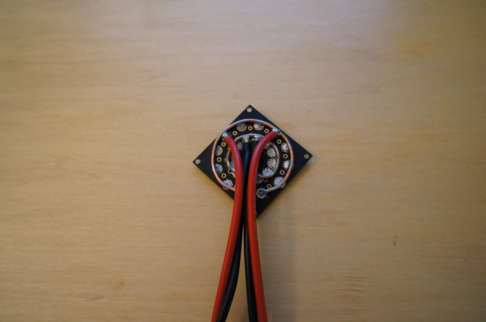

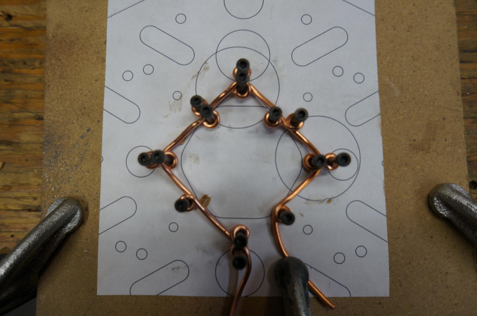

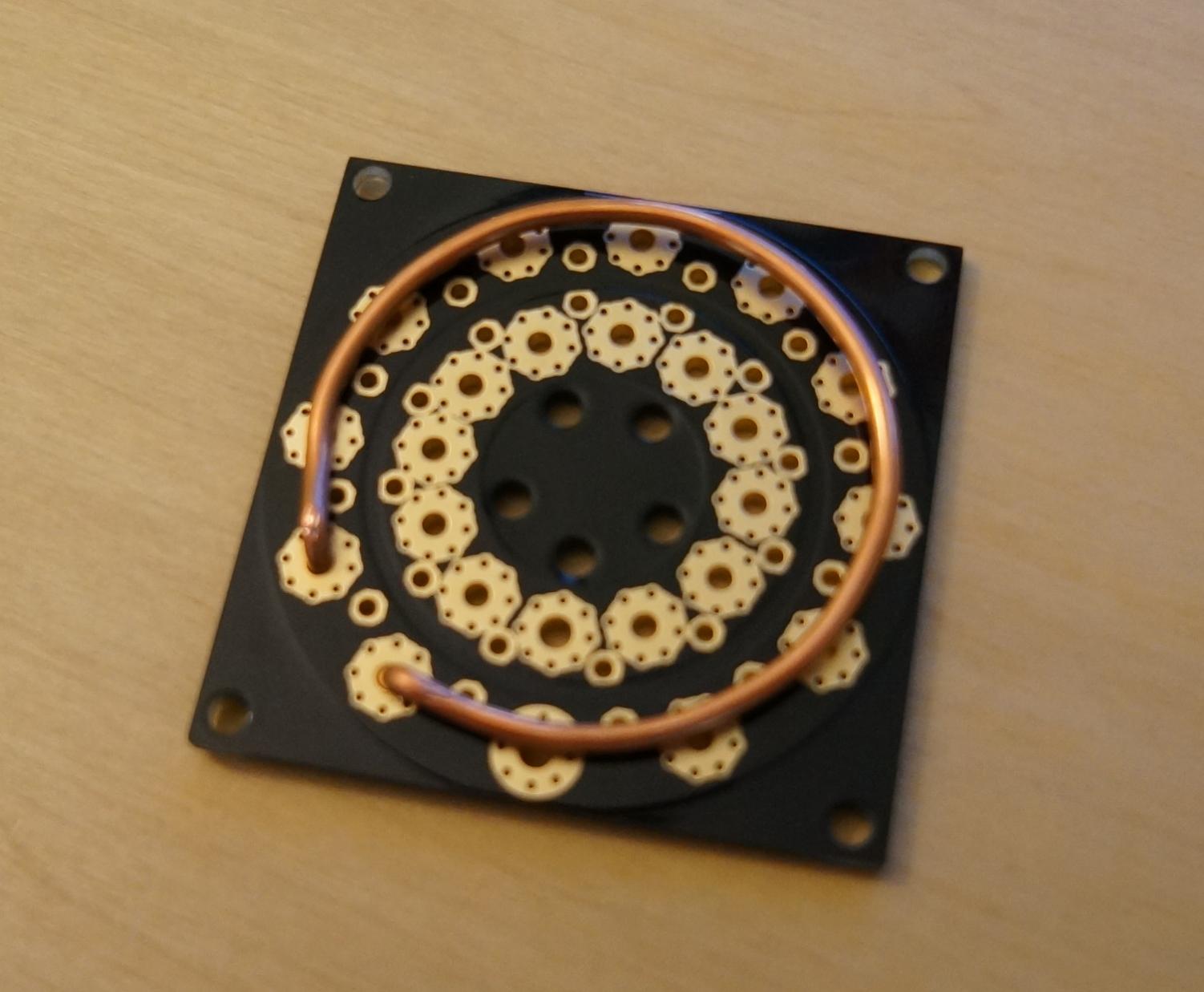

I'm also trying a modification of the Zoltair power board using a short length of 14 AWG solid wire. THe board has holes at each solder pad and the pads extend from the top surface to the bottom. These boards are really versatile and weigh a third of what my two copper loops would weigh. The idea is to solder the wire to each pad around the bottom so it adds to the current capacity of the board.

modified Voltair board with battery leads attached...original weight was about 12g, with the extra wire in place and before the battery leads were attached it's at 22g.

that seems like a very good & simple idea! I like it.
How many amps do you think it can take with the mod.
Kari
Nice idea Bart, but how many amps do you need? Voltair is already very thick and i'm sure it can handle very big octos current without issues. But if you're still worried how about 2 voltair boards?
Kari
i'm not an electrical engineer. i don't necessarily wish I was but when I start dabbling in worrying about the flow of electrons I have to be very conservative. The VOltair is advertised as having been tested to 72 amps and an Okto with Tiger 2814 motors can theoretically pull 200 total. with the battery in the middle of the board that would be 100 amps in either direction. I'm coming across references to people taking it to higher power levels but I'm not in a position to guess what it would max out at.
I suppose I could put a voltair board in line with some household 110v power and maybe run a table saw or something through it. Power wise, 15 amps of 110 volt power is the same as 110 amps of 15 volt power though I'm not sure how AC compares to DC which is what our batteries produce.
I'll fly the board I modified and I bought an extra to experiment with. It would be interesting and probably good for business if the Voltair designers put it to the test once and for all. It's a very compact and well designed package that could be much more widely adopted if the power rating were better understood.

Why even use power distribution? Just solder the wires together and isolate them with thermo retractable, it's way safer. Those boards make absolutely no sense, electrically speaking. Maybe only for esthetic reasons, but are just another thing that can go wrong with high currents, vibrations, poor soldering, etc.
i built my first Hoverfly quad with a wire harness for power distribution. it was as close as i could get to the minimum wire possible but it was a pain in the you know what to assemble on the frame. the power wires for the FC were left out initially and it was a bigger PITA to pull a joint apart to add two small guage wires into it. i might still go this route but the build i'm doing at the moment is my own challenge to tame the wiring mess that comes with std. ESC's.
looking at that picture again it could have been made even more easily by eliminating the #10 wire in the middle and just folding the two sets of battery leads directly over the #14 ESC branch wires. it was originally done by folding and soldering the battery leads over the center #10 wires and then adding the #14 ESC branches. so with about 14" of red and black #12 wire and about 6" of red and black #14 wire you'd have a harness. two esc's go on each of the four branches if anyone wants to try it and the esc's have to have the power wires pointing towards the center.

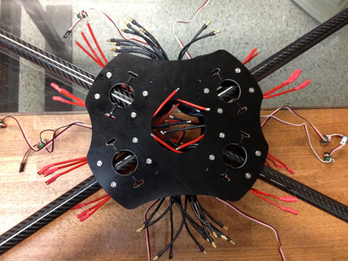

The board is nice only for convenience of soldering, nothing else. i spent 3 hours staring at my 18 wires to be loomed together and tried soldering to a washer, 4 wires ata time, wire lugs, copper disc. I ended up not being happy with any of them as it was just a royal PITA to get that many wires together in such a small space with such short leads to play with coming from the esc's. Thats why the PDB is so nice. I agree though, just soldering them is worth not having to ever think about that being a weak point. Bart, I have to be honest, I am thinking now about using your solid copper wire idea.

really? you spent three hours staring at it and I'm a day closer to actually flying and you think it's convenience only?
i like the wire idea too but it was going to be three times heavier than the board. single items don't ncessarily make things too heavy at the end but the tendency to let anything be heavier than it needs to be will show in the end.

but to keep the conversation going here's another idea. take a 14" piece of stranded 12AWG, bare an inch in the middle then fold it in half so you have leads for dual batteries with about 1/2" of doubled over bare wire. Stuff the bare 1/2" stub of the folded end into a #10 ring end terminal, crimp or solder. do the same for the other battery lead. put rings on your esc power wires and bolt them together. if it isn't the simplest and lightest way to do it then come back here and tell us what is. i might have to try it myself actually. it will definitely weigh a fraction of what those big wire rings weigh.

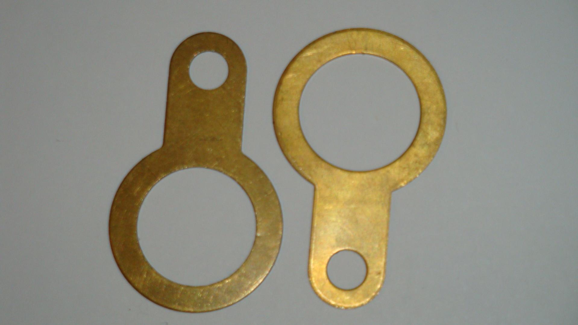

I addressed this problem once before and it worked well but was really overkill for my needs...It would easily carry 100A+. I don't own the MR anymore so unfortunately I cannot take any pictures to show. Purchase 4 brass Banjo washers, 2 for positive and 2 for negative. Seat each Banjo pair on top of each other so that the leg of each Banjo is 180 degrees away from each other. Now using a reasonably high powered soldering iron sweat each pair together. Each Banjo pair can be screw-mounted onto nylon stand-offs/pillars via the banjo legs. The MR loads can be soldered to the relevant Banjo washer pair at any chosen point. Finish it all off by painting it with a thick layer of liquid insulation. Assuming that the soldering is good it will last forever and it ain't ever going to suffer from copper land pattern peel back. I cannot remember the overal weight but it wasn't much more than a typical dis-board. (Brass Banjo washers are used for the glands on steel wire armoured cables and are designed to be robust and to take heavy fault currents). Just another way to help overcome a common problem.
@jes, i think if the joint was properly lubed and then wrapped, corrosion, resistance, and vibration wouldn't be deal breakers for the idea.
@david, I'm only familiar with banjo fittings used in hydraulic joints like brake lines in cars. Is the banjo washer just a heavy guage brass washer? maybe a link if you have one please?

Bart, the variety of Banjo washers that I used are very similar to the type used in hydraulic joints just as you have suggested. I've got a couple of the type that I used (not made up as a Dis-ring) lying around somewhere so I'll record their dimensions, take a couple of pics and see if I can find a source for them as they are rather than as part of a gland kit. I'll post it ASAP.
David.

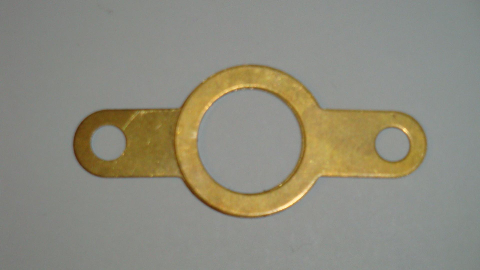

Bart, please see the following 2 pics...View attachment 4778View attachment 4779Weight and dimension are...
Individual washer weight : 4grams.
Washer dia.: 29mm.
Washer length : 47mm.
Washer centre hole dia : 20mm.
Washer small hole dia : 6mm.
Washer thickness : 1mm.
When the two washers are overlaid on each other as shown in the pic the small hole-to-small hole dimension is 53mm.
Of course there is sufficient washer body material to drill other holes in the washer 'handle' to suit other requirements.
As I posted earlier this idea worked extremely well for me but I do not know of anyone else that has experimented with something like this. Many MR frames now come with a built-in dis-board and that is possibly a way of things to come.
The washers are often referred to as earth tags and are manufactured in many sizes. Please see the following sites in the UK...
