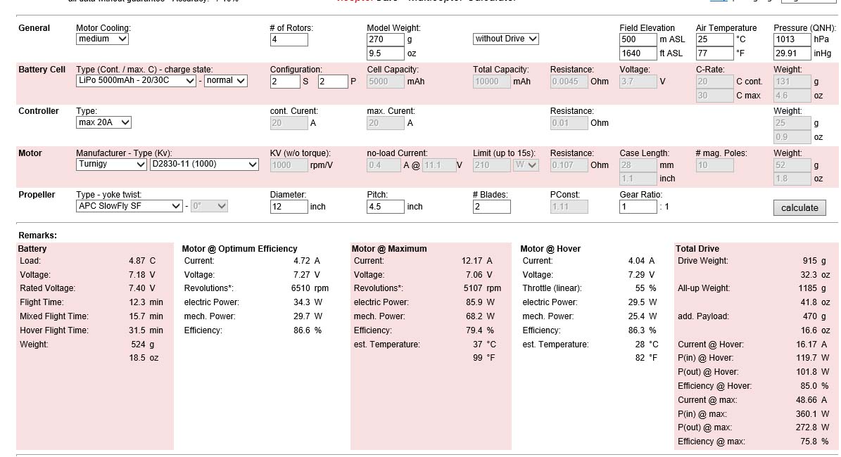

View attachment 16135 Hi guys this is the set up im planning on. batteries, motors and props as shown in ecalc screen shot, HK f450 frame, all in one ESC/PDB, AMP 2.6 + GPS board + sonar ( not sure yet about what I need to get telemetry on the transmitter), Arducopter flight control. also not sure yet how to wire the two batteries together, I'm guessing parallel?
Turnigy PXR TX with OrangeRX DSMX/DSM2 2.4Ghz Transmitter Module (JR/Turnigy compatible). I couldn't figure out how to get down to a smaller cheaper prop and get the flight times ecalc is giving me. I plan on getting a bunch of bullet connectors as I want to make this somewhat modular. any thought and advice would be appreciated.

That's some great flight time. I'm surprised on a 2S battery. Nice work.
The he only issue I see if that it will take over 50% for throttle. Maybe see if a 3S battery helps out???
