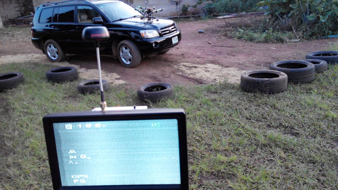

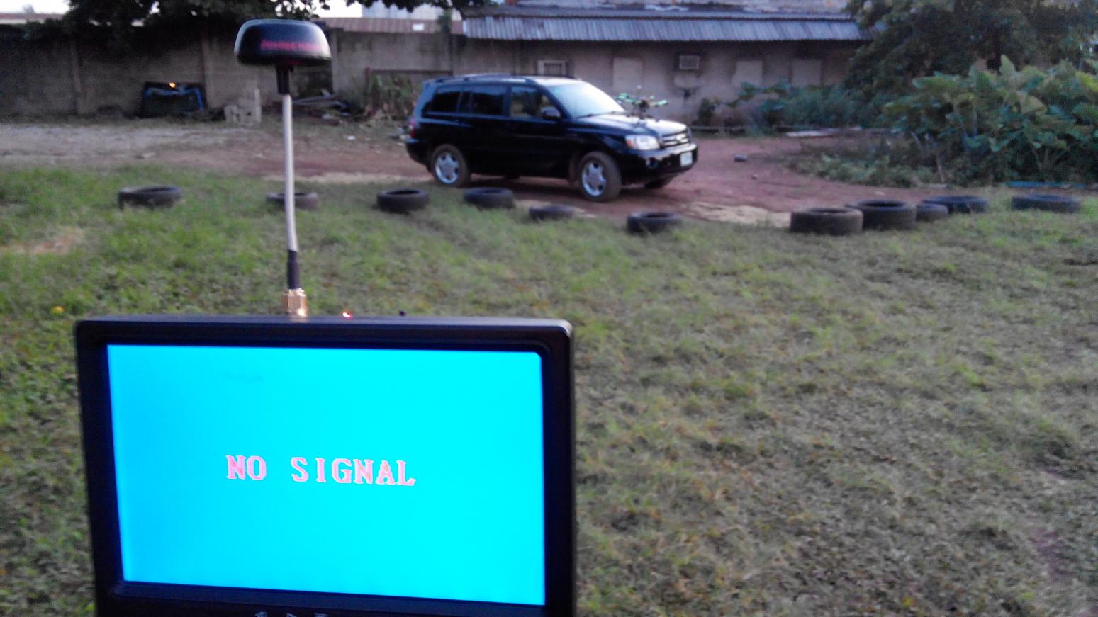

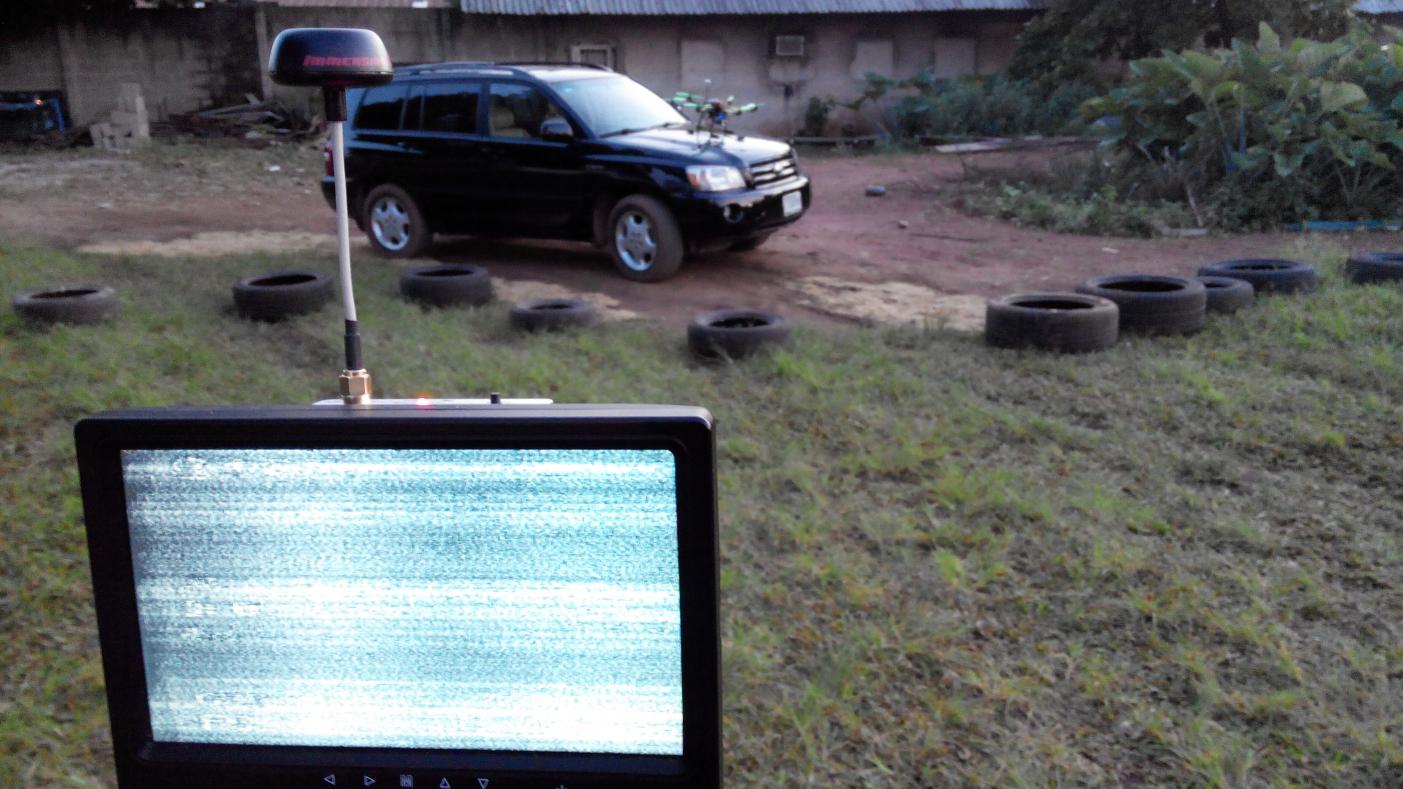

I have tried all 7 channels on my immersion Uno 5.8 for each of the 7 dipswitch options on my fatshark 100mw Tx. I have been through the manuals and havent gotten more than 10 feet and it goes "no signal" on every channel if i go an inch further, My best channels are 5740 and 5760 on the Tx. I've read posts that claim good signals even in another room indoors and I'm wondering what I havent done. I use a SMA stock fatshark cloverleaf Tx and Skew planar Rx antennas. I have uploaded a picture of my machine. Any good advice will be appreciated. I just need a nudge in the right direction. Been on it all week and the lightbulbs are out.
