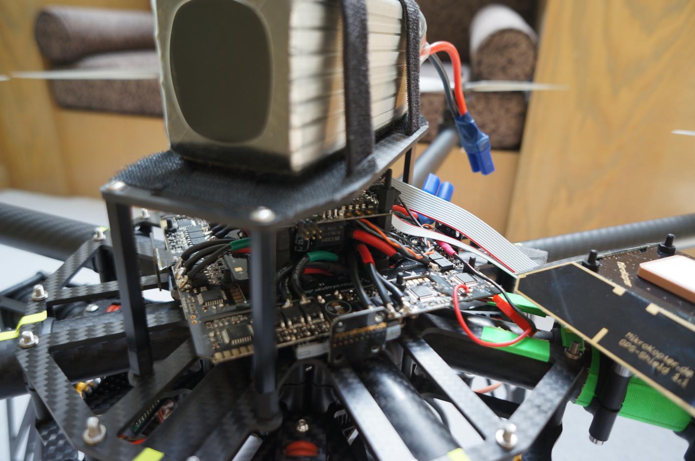

I made use of AH today on a job in very windy conditions. Im having to use a servo to fire the shutter on my camera and so it has become very handy to use the AH to free up some brain reserves to enable me to concentrate on firing the shutter and still fly the Hexa. I have somehow got lucky and got my AH to work well from the first gain settings i used, I havent done any tuning of it yet but its holding within 2 feet of its altitude.
Anyway the job i shot today was very windy, i put my Hexa up at a decent height, engaged the AH and for 3-4 minutes moved the Hexa around to get the right shot without having to worry about my throttle control. Im one very happy camper. I have the sensor protected from the sun via the frame plates and the gain settings for me are at 60 on a 3.5kg flying weight. I think at some point Im going to have to buy a 3rd board and then eventually the HF Gimbal board.
