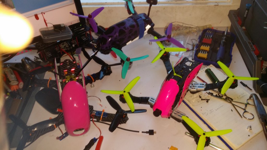

Yes the motors spinning once armed is typical thru all quads. Just you can turn it off on DIY flight controller.. as for esc odious ly you haven't had an accident cause there aren't any escs. So calibrating them.. well there's no them.. use the mrs app there's a calibrate page. That calibrates Everything. Its a 15 in 1 board. Which is both pro and con.. con odious ly you can't change out for different equipment or just replace one bad piece.. but it's super user friendly. Just much different from all other quads.. so don't expect to buy one of these beauty's and learn how DIY quads work and operate.. Cause there so different it's not funny. But man is my align a blast... definitely my favorite out of the 4 other diys. Oh and attitude is the auto stability mode.. not sure the gps ones.. there's attitude manual and sport manual that I know off. Im still playing with the different stuff.
