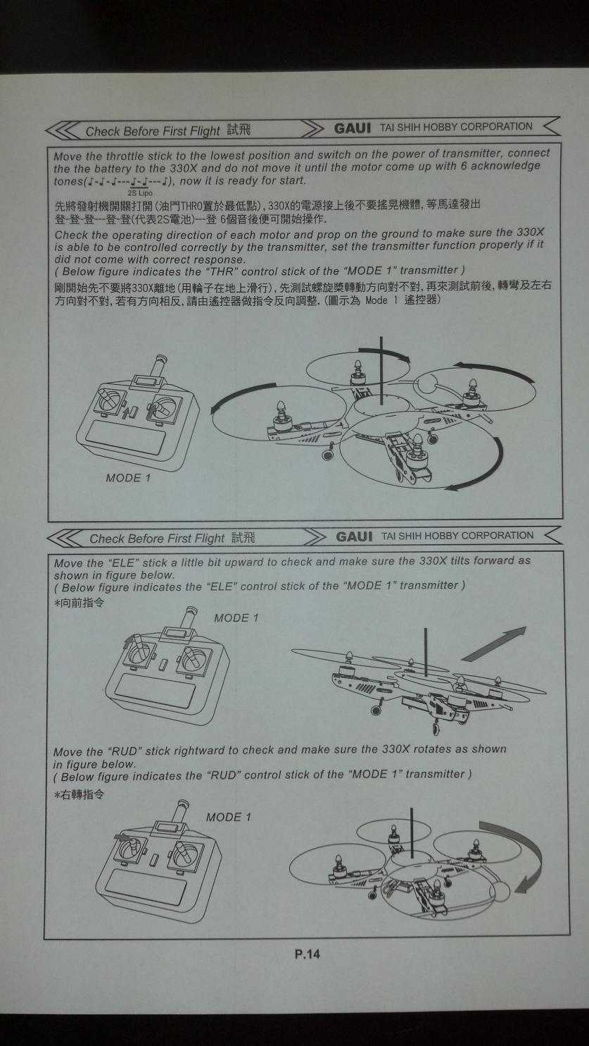

Check wiring to motors is as it should be, check esc and Rx wires are all as per manual.
check direction of rotation of all motors is as per manual, check your A and B props are where they should be.

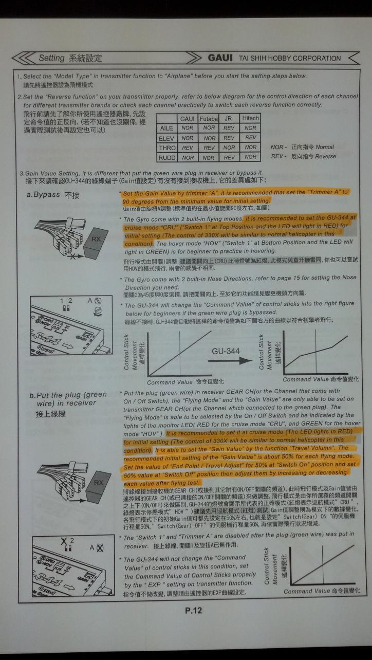

You may have your GU344 gain set to high or low, about 60% should be good to start then you probably have to down it to about 50%
Probably best to switch HOVER/CRUISE modes with the dip switch on the FC for a start, ie disconnect the green wire from Rx / FC.
Set it to hover first.

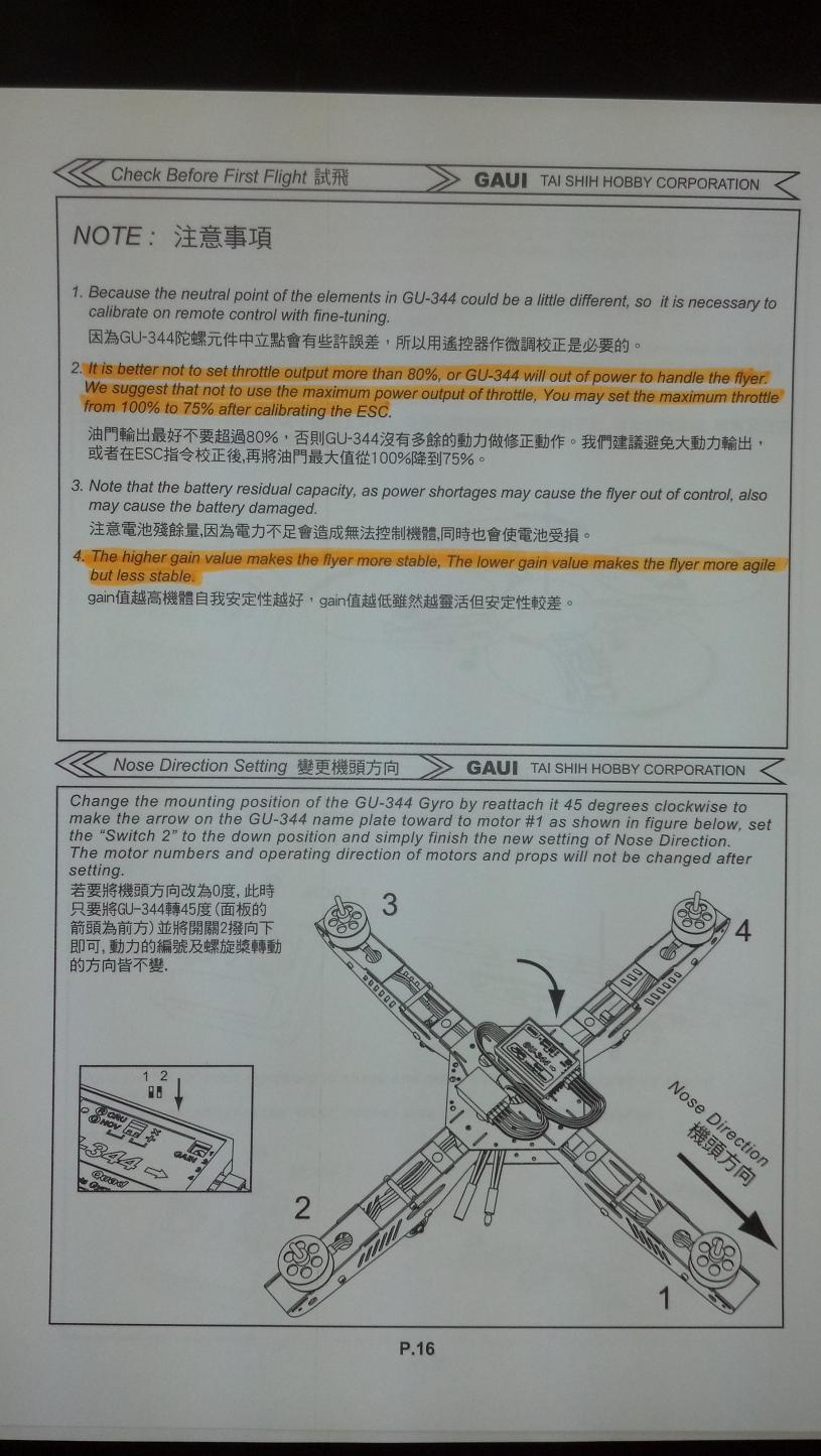

I have an original 330X and they can be cranky at times. As Bowley mentioned make doubly sure that each motor is connected to the correct port on the GU 344 and that each motor is spinning in the correct direction as well as making sure it has the correct propeller installed. Most of the instances where I've seen the problem you desccribe it has been due to a motor that was either connected to the wrong controller port or not spinning in the correct direction. If you want to post some pictures of the setup it may help us see something you might be missing.
One other thing comes to mind, cruise mode is much more stable than hover mode which may not make sense but it's the reality of the GU344 controller, so if you're trying to fly in hover mode switch to cruise mode and see if it helps.

Thanks for the information. I have checked its correctly the rotors are rotating in the correct position. I believe you can change the hover and cruise mode with the tiny little switches on the GU344. I will try that. I have just taking it out and its still tilting, but managed to get it bouncing off the ground. Well it did fly briefly! The throttle just seems so extreme once its off the ground. The trick seems to be to keep the Trottle where it is, and adjust the Aileon and it will naturally increase? I will post some pics to show you. Thanks! Stu

Hi Phenoman, I have the 300 xs if you are using the GU-344 i would forget the hover mode side of the flight controller, its not the best and as someone told me its like flying after drinking 5 pints of larger.
when i had issues with me GU-344 i found the best thing to do was go back to base settings and reset the ESC's. if they go out of sync you get all sorts of problems with motors starting at the wrong time etc.
I assume you have the manual if not drop me a PM and i will email you the page on how to set it.

Hi Mark, I can only dream of flying this unit like these videos! At the moment its seems like its never going to get off the ground! I have looked at the manuals with the ESC's and I cannot see how you reset them? Do you mean unplug them all?

Just follow the proceedure in the manual, basically just a calibration ie switch on Tx put throttle fully fwd, connect flight battery listen for the tones and return throttle to zero, thats basically it as I remember, details are in the manual. One thing I noticed with my330 was if I had the gear channel connected ie gyro and switched between hover and cruise with the Tx it would seem more unstable in hover than in cruise. It must be something to do with my gain settings because the opposite was true when I disconnected the channel and used the dip switch to change modes with the correct gain set on the GU344 pot.
