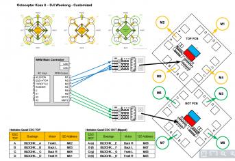

henrysj
Hi Cheshirecat,
Sorry didn,t read your post carefully enough - it's a clever way you've done it to keep redundancy. I got sent this from Andreas regarding the mapping to the A2, I haven't tried spooling up yet but will take it for its maiden flight today so will keep you posted if I have any spool up issues.

henrysj
Hi Quinton,
You can get the Herkules Octo board which comes as one unit which controls all 8 motors but it is basically 2 quad boards connected together as you mention. What Chershirecat has done, which stumped me to start with, is although he hasn't got one board controlling all the top motors and the other controlling all the bottom motors, he has got one board controlling 1 of each motor on each arm adn therefore if one board failed it would still be a quad. (I think he has just made a mistake saying M3 is running CCW when its running CW)
Sorry the image is so small its a pdf so had to do a screen grab can email it to you if you want though?
