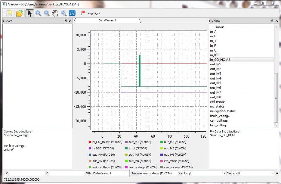

U Channel & IOC active at 22 sec...
I assume you have RTH set to U Channel.... with IOC set to return forward or backwards....
If this is the case....
It went into failsafe.....
Either by loss of TX or by some other means....

Yes that corresponds to the loss of control. I went GPS-Atti then radio off to trigger failsafe. This is a fantastic discussion and I'm glad I joined this board.

All three happen at the same time 21.683 sec...
1. Flight mode goes from Manual to GPS
2. U- Channel Failsafe Initiates
3. IOC switches on.
As soon as it gets a GPS lock it is in failsafe & IOC....
I bet with a home point other than where it was taking off from...
and trying to fly home.
