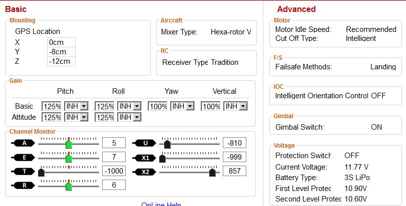

At first, the throttle is VERY touchy. No response to input until you get to halfway and then it blasts up. Once it's been pushed to the max and pulled back down, sensitivity to adjustment is restored. Is this normal? Take-off in full power?
In GPS and ATTI modes, the motors will run normally until I get over 50%. Above 50% the motors will start pulsing; accelerating and dropping over and over. Switching between ATTI and GPS does not change the pulsing. Switching to Manual returns throttle response to normal. Dropping below 50% in GPS or ATTI returns throttle response to normal. (You can determine the Modes in the video by the LED reflected on the locker.)
Is this an artificial condition that I've created by clamping it to the bench?
Above 60% in GPS or Atti, it runs normal for a while, and then starts pulsing. Sometimes I loose the double green blinks from the FC and get single greens. (Same for yellow in ATTI) It makes this change with no input from the radio. Dropping the throttle below 50% and switching back to GPS or ATTI restores normal double blinking.

Re-Bind: The AR8000 and it's satellite both stay lit red; but I went through the binding protocol anyway.
There are entries in the Voltage protection fields, but VP is turned off.
Reading elsewhere, I'm thinking about re-soldering all the connection points to the 30A ESCs; but since it runs true in Manual mode, could an ESC connection really be the problem?

"At first, the throttle is VERY touchy. No response to input until you get to halfway and then it blasts up. Once it's been pushed to the max and pulled back down, sensitivity to adjustment is restored. Is this normal? Take-off in full power?"
Yes this is normal to help you out of the ground effect.
"In GPS and ATTI modes, the motors will run normally until I get over 50%. Above 50% the motors will start pulsing; accelerating and dropping over and over. Switching between ATTI and GPS does not change the pulsing. Switching to Manual returns throttle response to normal. Dropping below 50% in GPS or ATTI returns throttle response to normal. (You can determine the Modes in the video by the LED reflected on the locker.)
Is this an artificial condition that I've created by clamping it to the bench?"
I think it is not straight on your table and it is trying to correct it's self, try with it flat to see if you get the same conditions
Above 60% in GPS or Atti, it runs normal for a while, and then starts pulsing. Sometimes I loose the double green blinks from the FC and get single greens. (Same for yellow in ATTI) It makes this change with no input from the radio. Dropping the throttle below 50% and switching back to GPS or ATTI restores normal double blinking."
The double blinking is indicating that you sticks are not in the centre positions.
