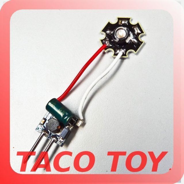

Here's the unit described by benchmark months ago:
The unit appears to have a big resistor already installed. I ordered that light. Got quick response. It's been shipped.
It'll be affixed to a carbon tube mounted across the rear arms facing backwards. I have an on-off switch suitable for rc. That big resistor means there's less chance the thing will get too hot.
I don't know. I'll have to experiment and see. One thing's for sure. The cops will see that bright light in a minute. LOL Looking forward to talking to an officer about hobbyist UAV,s.
