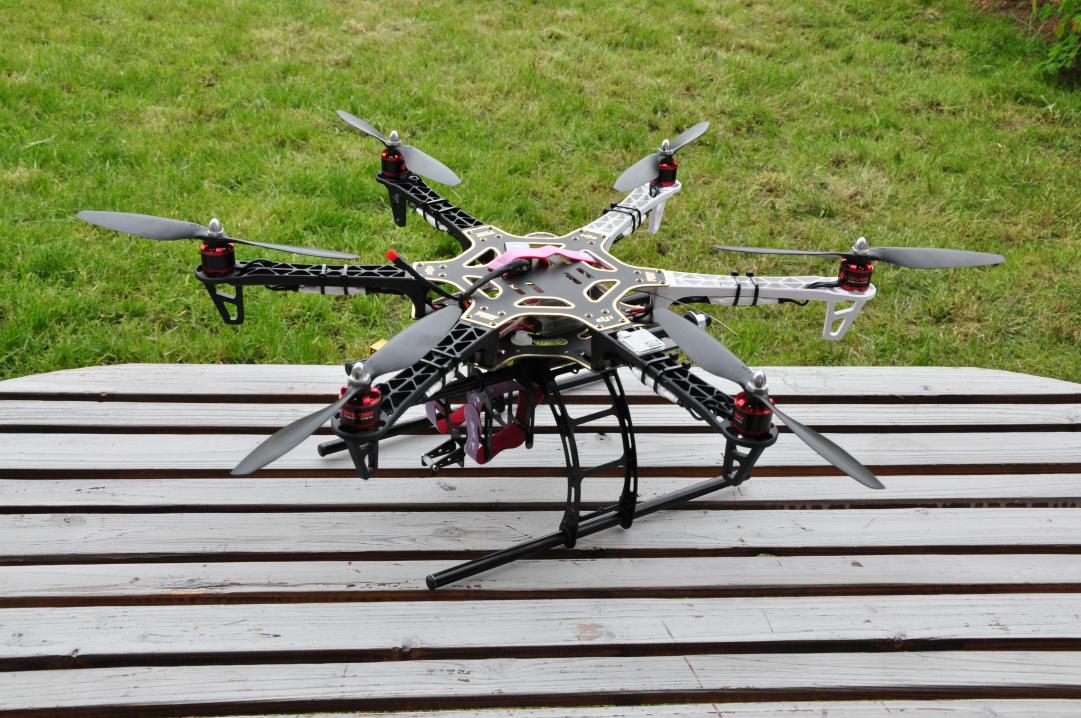

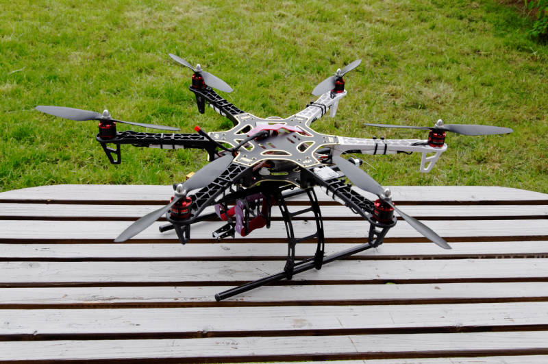

I have both F450 and F550 since yesterday : I made my first F550 flight yesterday and found it more stable than my F450, especially versus wind.
This test flight was done with default gains, and with a 4S 5300 mAH lipo. However, the F550 has more inertia in its movement, at least with the default gains.
I find the F550 better for calm and fluid flights and the F450 better for fun flights. I however need more flights to confirm this...
