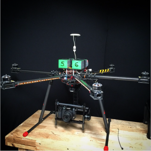

Since I had an ESC explode on my X8 (Sucked, as that rig was looking to be super efficient) I rebuilt my "Cinestar" 6 last night with some Tarot retracts and a SuperX. Came together nice! And it's light! All set for the H6. I may have to tune the damper a bit as it seems a bit wiggly, but I guess I'll fly it first.
So today I want to try a few handheld tests, get the Cinestar up with 6.3lbs under her to simulate the Gremsy/GH3/4 and batt and if that goes well get the H6 flying in the next day or so!

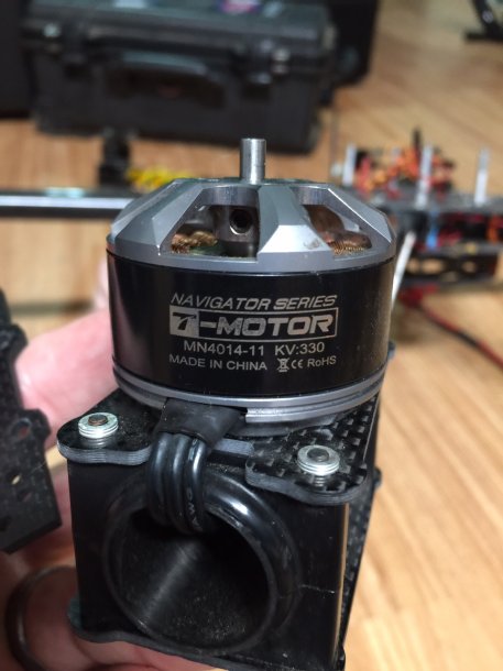

What are the motor sizes on there (guesstimate)?
