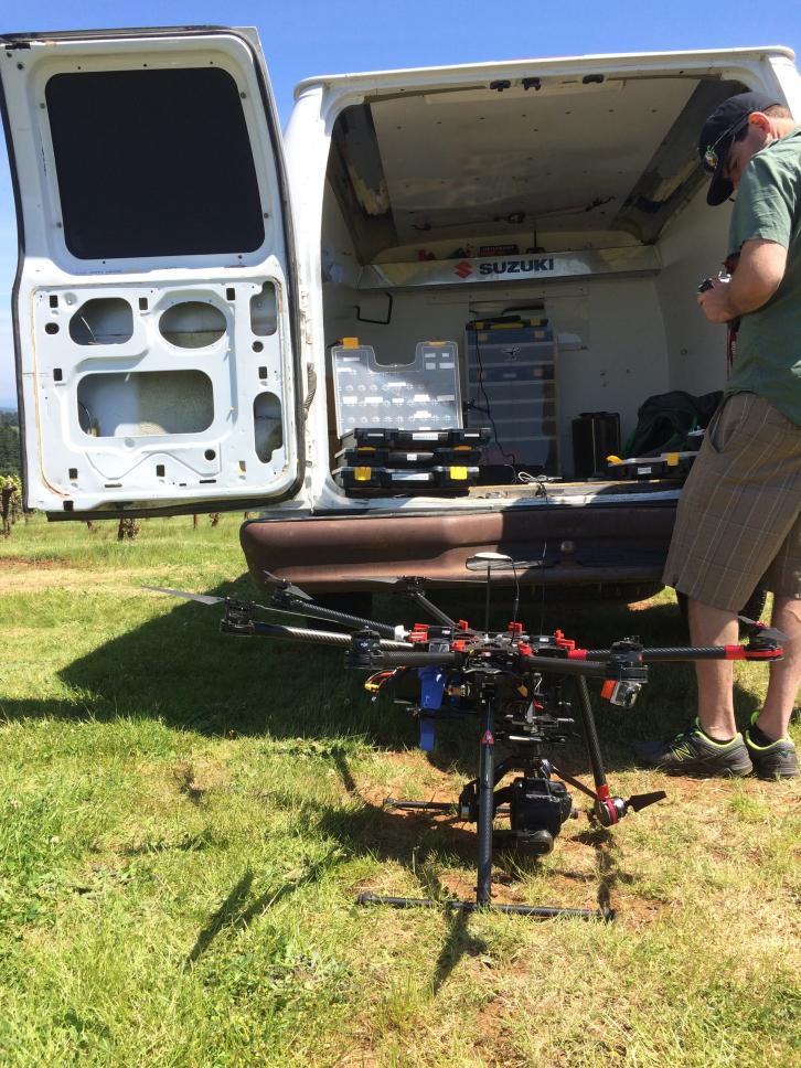

Just this a.m. I was assisting a colleague by helping with tethered flight. But in our case, the tether was to ensure the MR height was aligned with the client's specific height requests in taking panorama shots of some new condo development. The intent is to show potential clients precisely what view they could expect from the various storey balconies. Panoramic shots were later stitched together for the full 360 deg view. Here is photo.View attachment 18581
