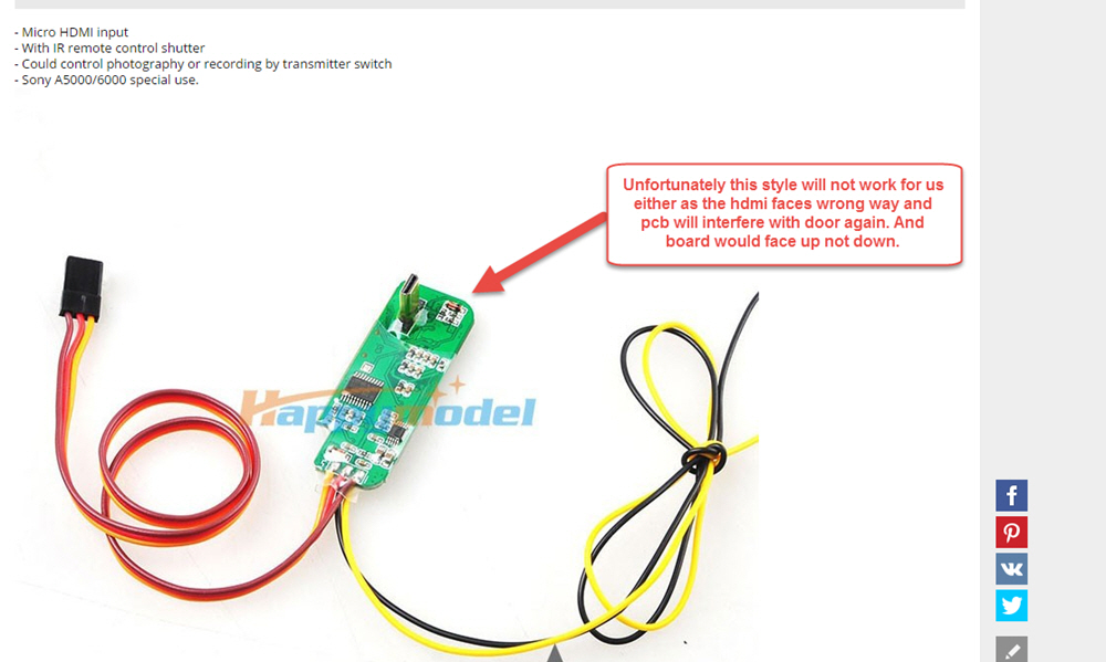

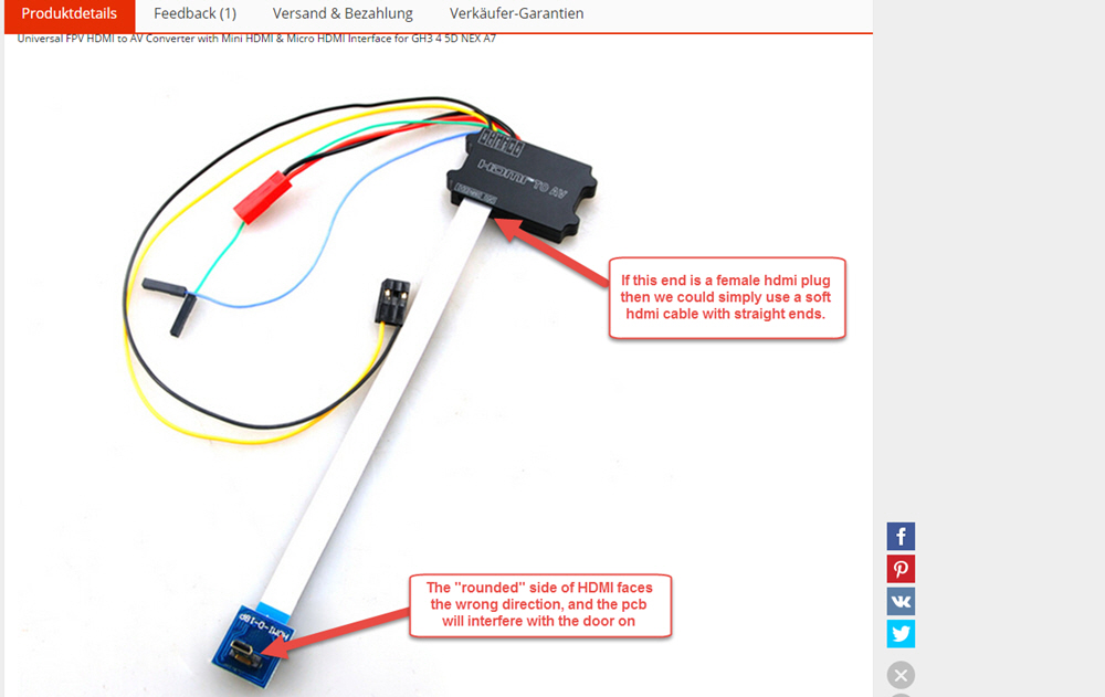

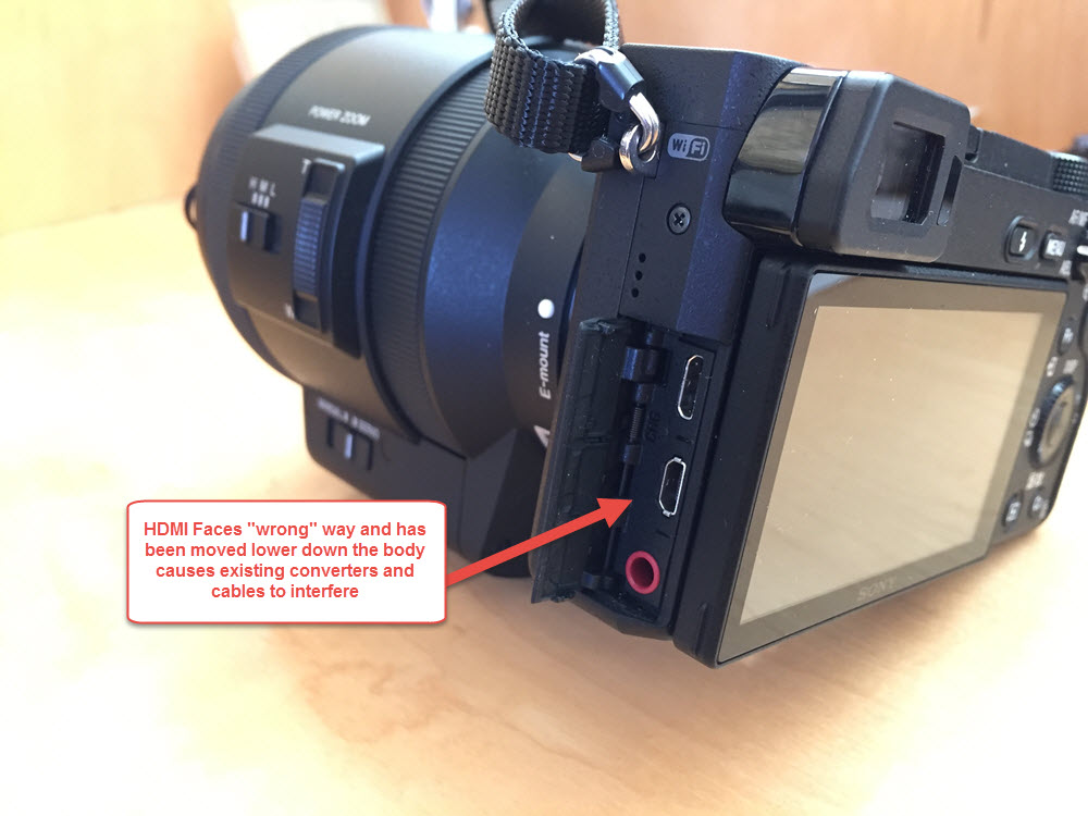

Thank you Oschefer, I got the same reply when contacting Helge directly through his site. The problem I have found with all the Universal HDMI - AV converters available is the the Cabling or circuit board interfere with the hdmi door on the a6300. Sony decided to move it and flip the orientation which has left us in a bind. I will post images to show what I mean:

I Found this image of the naked pcb in the AV converter that Helge recommended. It shows there is indeed a plug on the pcb for hdmi input but sadly it is not a female hdmi plug... The search continues.

The orientation of the HDMI-connecter in conjunction with the position of the protecting door indeed is a problem for most accessories like AV-converters. DJI provides a micro HDMI to micro HDMI cable for connecting a GoPro with the Lightbridge (spare Part10). Its only 15 cm but the connector has the right orientation. On the other end you can connect an adapter from micro HDMI (female) to whatever you need. Not the perfect solution as it requires two cables and one adapter but at the moment it seems to be the only option.
