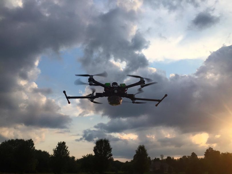

How would you use retract on an X8?
Add "Nub" arms or get frame plates that allow them.
With a Vulcan or a Cinestar type frame, just use nub arms... meaning cut arms down and mount them in-between your "X" make them like 4" long and mount the retracts.
