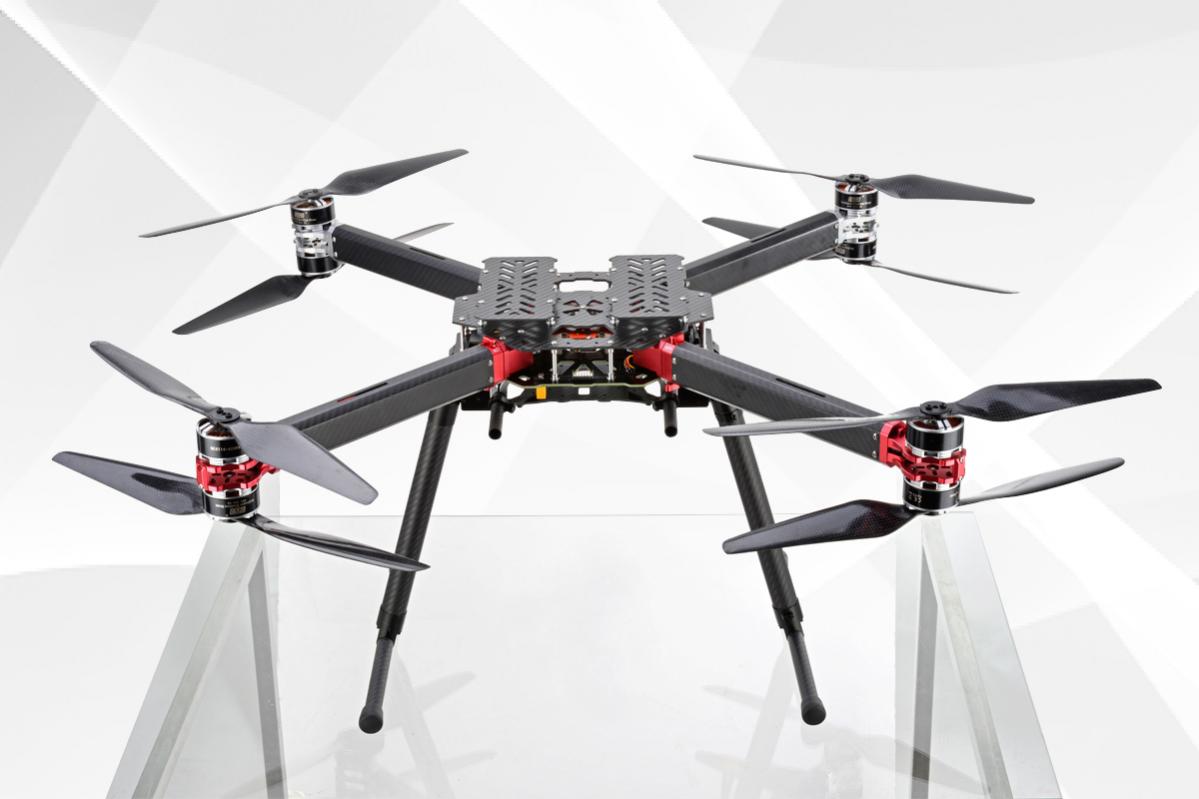

NEW D800-X8 Y=Tested today. AWESOME.
Xaircraft
I did a unboxing video, but haven't uploaded it yet.
here is a link to it.
FPVone.com
Anyway, Used a NAZA M V2 and dual 5000ma batteries.
I have never seen anything personally fly this well. It is just say, incredible is a Understatement.
It has the screw type retracts,(Ultra Smooth) uses 2s to 6s voltage input. It is a ARF kit,
Motors, ESC's Power distribution and retracts and props (ALL Carbon Fiber)
I am using a Eagle Eye mount for a 5D on it. I flew it 8 minutes with no camera mount and the batteries were cold like they had been
laying on the work bench. Used only 1800ma out of 10,000.
Glass smooth
Anyway, Can't wait to get a camera on it. Will video it flying tomorrow and see what you guys think.
Will add unboxing video and other pictures here WOW what a AP machine.
I think this is the first one of these (Rotorbotz) in the USA.
FPVOne
Ι want to order one . If you have a video, you promise please share it here .
FPV Style video, no edits, added music and shorten it to remove GPS hold section (parked) ,
adjusting goggles TOO bright at beginning and clipped the end for upload time.
Eagle Eyes Gimbal Alexmos 32bit with Extra sensor (NEW Style!)
Nikon D3200 (Stock lens) << (Not setup properly) First use !
Rotorbotz X8 800mm
4114 420Kv motors
40a esc
15 x 5.5 carbon props
