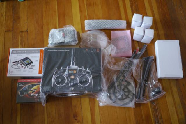

Today I received my first package from Quadrocopter.us who have been great to deal with.
Included was:
Okto2 Basic set (pre-soldered board) with HiLander 26 landing gear
2x VoltOn (Batterist) 6600mAh LiPo's
DX8 System
Vuzix video goggles
Hyperion EOS 0730i NET3 charger/balancer
12v ground station battery
MD1 Camera mount
still waiting for:
FPV cam
FPV tx/rx

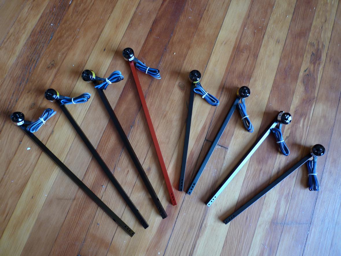

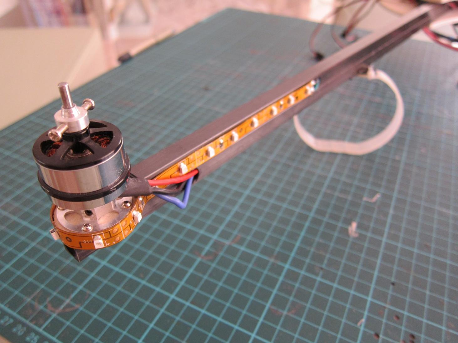

Trying to attach the motors to the outriggers has been crazy frustrating. Probably because I don't have a magnetic screwdriver. It seems absolutely essential to have one so back to the store I go. Does anyone here use heat shrink tubing? Any tips?
Macsgrafs
Have you got an old speaker? If so pull the screwdriver across it a few times & then you wont have to go to the store.
ctbon
Thanks for the tips, guys!
Speaker trick works a charm, Macsgrafs!
I'm glad I checked the forum before going out. :D
Motors are now attached...quick and easy thanks to the magic of magnets!

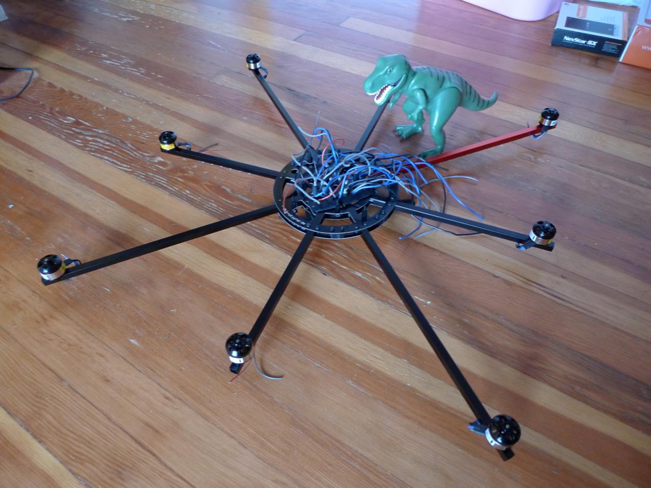

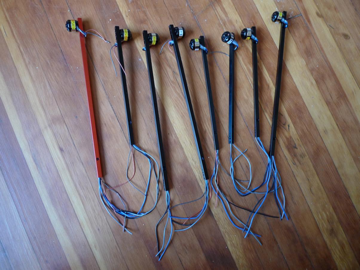

ctbon
Bartman! I read your thread after I ran the wires...oh well. I sure don't want to take 'em all out. I did use some adhesive on the motor screws but not on the center plate. Should I take them out and use adhesive? They feel very tight.
Here is where I'm at now...I'M GOING TO STOP FOR THE DAY AND HAVE A BEER. Hah! I didn't mean to hit the caps lock but I'll leave it...it's fitting. Cheers for all the help, guys!
