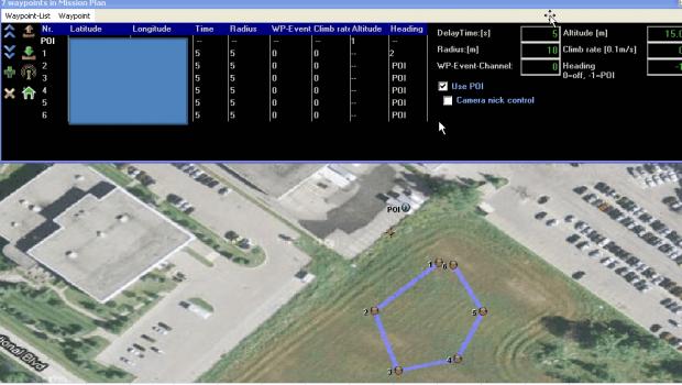

As for the new features, I haven't gotten the POI heading working.
I've attached my waypoint settings. Perhaps you can see something I'm missing. It didn't try pointing in any directions (I should have also used WP2 instead of 2 for pointing towards waypoint 2, 2 should have caused it to point west)

The MK seems to handle the same after the update.
As for the altitude settings for waypoints, seems to work however I didn't read the WIKI closely enough and when I tried going to a high altitude after a couple low altitude tests, I ended up having to dig mud out of my motors. The climb rate is in .1m/s and not as I assumed 1m/s. It appeared to take too long to get to my target high of 50 meters but seemed like it was getting there so I didn't stop it and lost track of time. Eventually it started to descend, faster and faster, the battery was almost dead. Looks like it ended up free falling about 50feet into a muddy farmers field (can this be considered another version of auto landing). So entirely my fault, fortunately, my only damage as far as I can tell is 3 props.
The setup looks OK, did you use Carefree mode while flying the waypoints? Carefree has to be working and turned on for POI to work.

RTRyder, yup that's likely the issue, carefree.
I'm just waiting on 1 replacement prop which should be in my mailbox today and should be able to retest by the weekend.

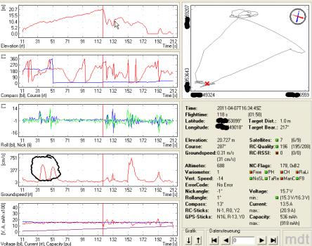

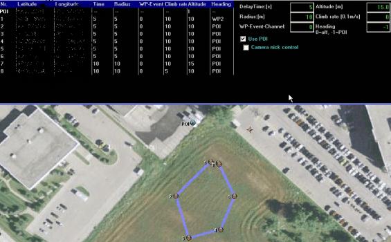

FlyEYE
I tried out the new features of .84 again and it didn't quite work as expected.
In the GPX analyzer graph, the 2 peaks circled in the ground speed graph represents going to the 1st 2 way points. The MK did point in the correct direction for waypoint 1 and 2 (bizarre seeing it spin around on it's own) but at 2 it just kept on rising slowly. At the vertical red line I switched it back to PH and took over since it wasn't going through the waypoints correctly. It was suppose to go to 15m at waypoint 7 but started to at way point 2.
Any ideas why?
On another note, I hate flying with carefree mode, my mind refusing to ignore the "front".
View attachment 223View attachment 222
