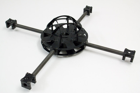

I like the Quadframe US 530mm Medium lift frame.
It's more "real' looking tough and can take the electronics you are describing. You can choose a ton of LG for it and fit any kind of gimbal you want.
just a thought.
