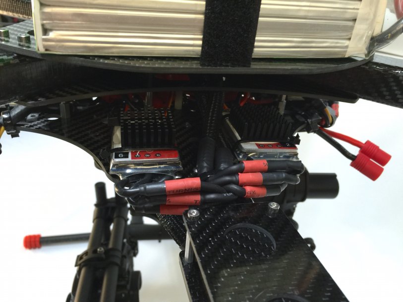

I totally forgot to post my results form inverted 3g dive challenge...this pretty much sums it up :) - odd enough, no prob doing it with mini and NAZE equipped heli -
