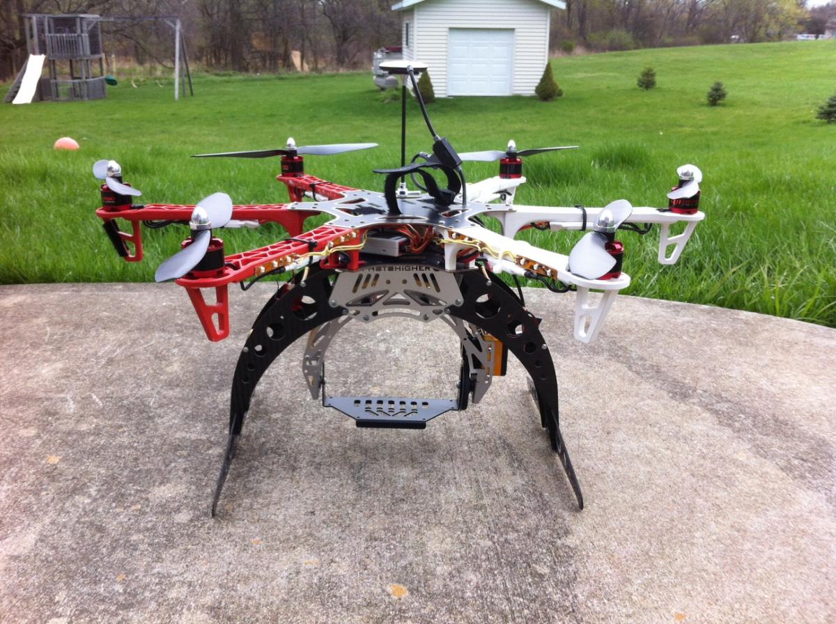

UAVproducts
Formerly DJIUSA
Yes, I switched over from DJI 10" to Graupner 10". This is on a F550 with the Av130 (soon to have the RSGS I'll pick up at NAB next week). With the Graupners its much quieter, smoother and the DJI motors come down cold to the touch. I had no issues with the DJI 10" props besides the motors seemed to run a little warm. Not burning hot.
My auw with 4s 5000mah Turnigy pack is 5lbs 2oz (2325g). I get a solid 10mins and still have 20-25% left in the packs.
With the Sony NEX5n I was around 5lb 14oz (2665g). I'll do some flight test today with that and check duration. If I get anytime to fly instead working.
The simple isolator mount works amazing. As far as High Freq vibrations, they are gone and I'm very pleased with it.
I think this combo or Gary's GP mount are the way to go.
This pic is a couple weeks old. We have made some tweaks to since.
