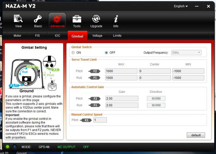

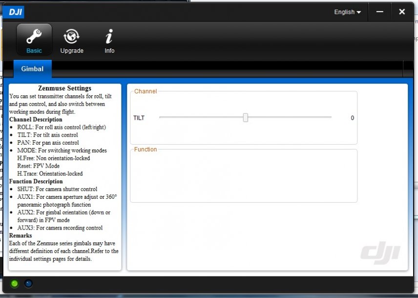

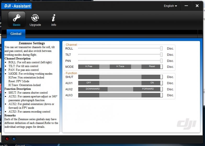

So I've moved onto the H3-3D and having trouble getting the tilt control to work in a slow motion. It seems like there is no way to control the tilt speed. I've read numerous threads with inconclusive results. Some say they needed to program their radios which to me seems like an aweful lot of work when the DJI assistant software should be able to provide that capability. Any way, here are couple screenshots of my situation. All software and firmware are up to date, any suggestions as to what I may be doing wrong or if this is a common problem with the tilt function is appreciated.
When I launch the Zenmuse gimbal control assistant I get the full gamut of control features (photo Zen 01) but once I plug it into the Zenmuse via USB I get just a two boxed screen with "Tilt" and "Function" but the function has no adjustment ability. Frustrating to no have the ability to slowly pan down on the tilt axis.
Thanks,
John
