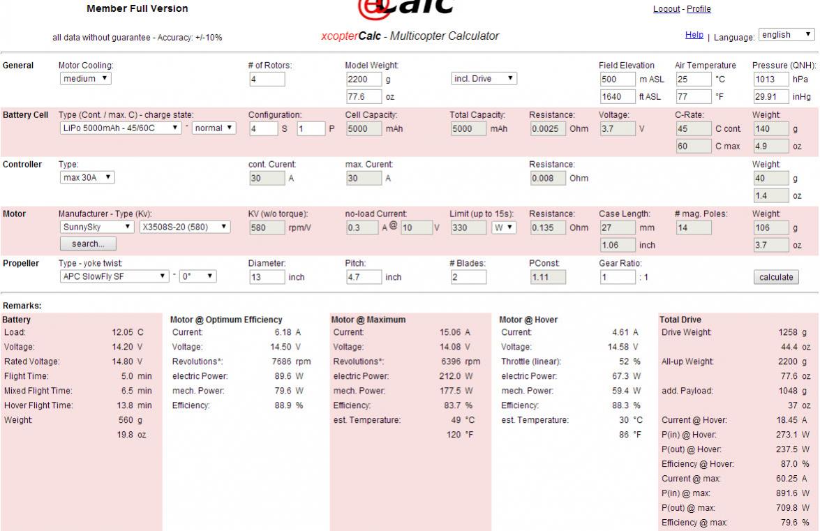

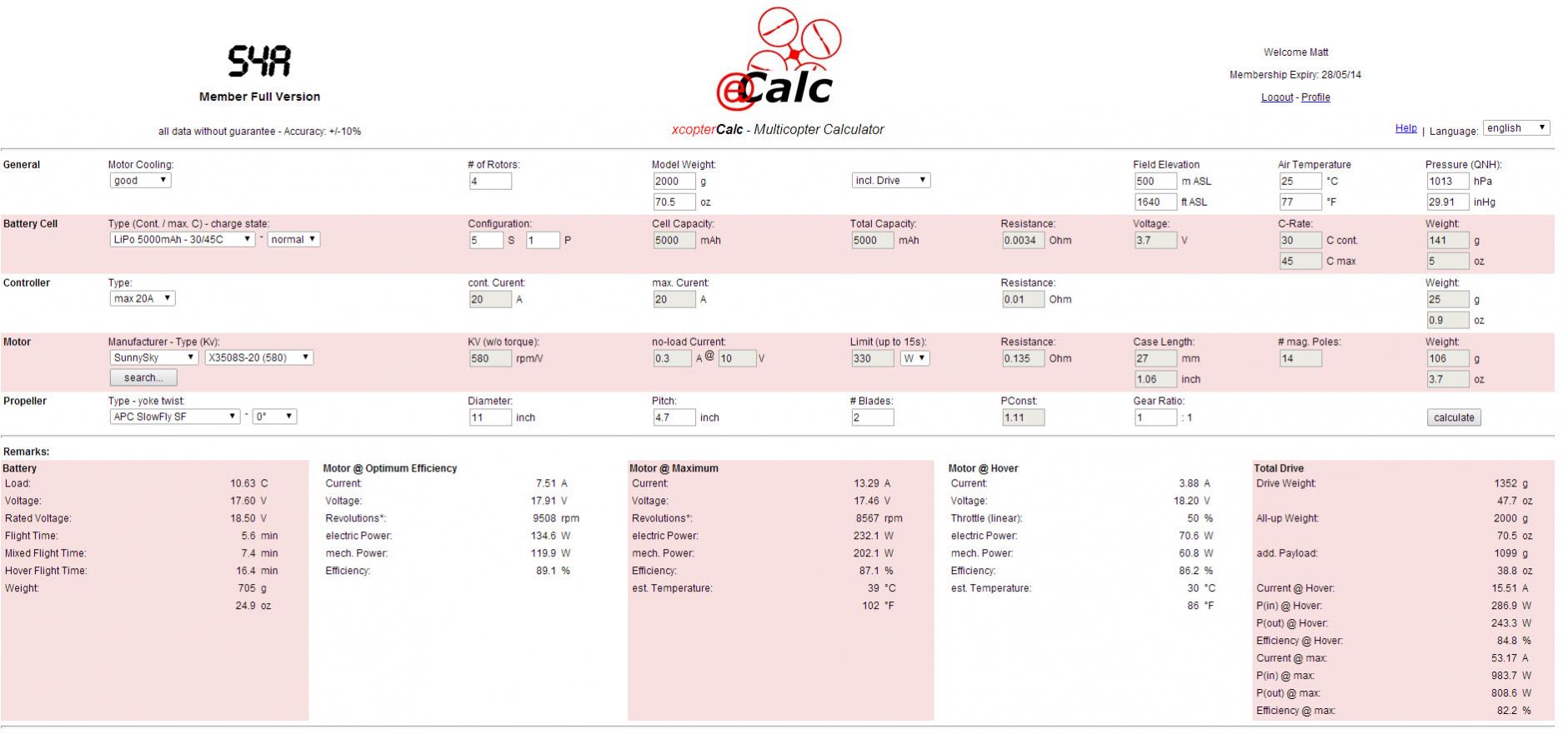

I have a pretty good eCalc:

One thing I noticed right off the bat is that your Motors, ESC and your battery selection doesn't match. You will fry the motors and the ESC with that battery. You need to pay attention to the number of cells/voltage of the battery and the requirements of the parts you're using. The battery you have chosen is 5S (18.5V) Your motor can only handle up to 4S (14.8V) and your ESC is the same (you already noticed that about your ESC selection). You either need to change your battery or your motors and ESC or there will be instant disaster.
The prop choice may also be a bit too small for that motor.

Wow, I hadn't even seen that the SS motors limit was 14.8... Thanks. Also, you are correct, with a 4S battery, eCalc likes a 13x4 better, slightly higher estimated flight time, but less estimate hover time.
However, this brings my hover throttle up to 59%. Any suggestions as to whether I should change my motor selection or bump up to 14" and accept the shorter flight time and/or bump up the battery to a higher mah (and cost)?

59% is actually fine. You want it at least at 50% and a little higher means that you're loading the props better and the quad should be a little less twitchy. You just don't want to go too much higher than 59%.
As far as motor / prop selection, the best way is to just plug in different options in eCalc to get as close to the results you are looking for. Bigger props usually means lower Kv motors and moving up to 6S batteries to get the most efficiency...but there are many variables. Remember, eCalc is just a guideline. The real-world performance may be better or worse than indicated.

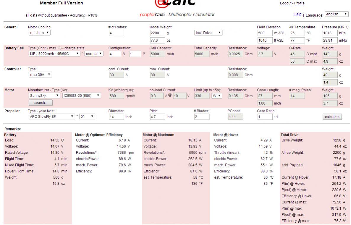

Thanks all for your comments and suggestions! I decided to stick with the motors (SunnySky X3508-580) and work around the 4S limit. Decent numbers on both 13 and 14" props, definitely the way to go.
13"
14"
(edit) I don't even know if I can mount 14" props. This thing is going to big one big spinning prop.
i would suggest you check out my calculator which i created for exactly that purpose (link in sig). I checked and IF your wheelbase is 585 (it does not say, it only says 'width') THEN the max your frame can handle is:16" (with a very slim margin, so im inclined to say 15" max).

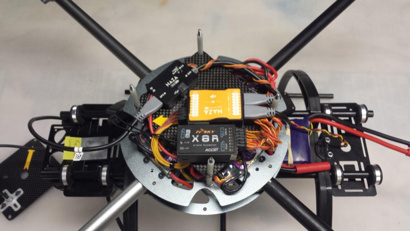

shiftty

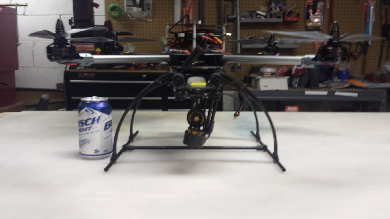

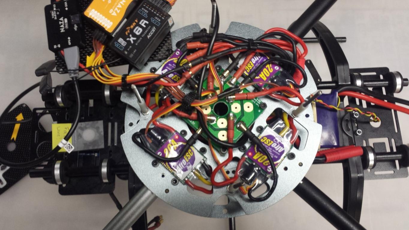

It's taken me much longer than planned, which I pretty much expected. It still hasn't flown other than hover testing, hoping to change that this weekend.
Ignore the landing gear, it's temporary only...
Busch Light can for scale:
Main chassis
Second platform
3rd platform, sans props
Short list of components'recent additions so far:
Turnigy 9x Dead, tried to solder a USBASP to it and it did not work out...
Taranis x8r Tx/Rx - Love it
13x4.7 Turnigy props
14x4.5
Afro 20A ESC's - I abandoned the Qbrain ESC in favor of serviceability
Still a ways to go before prime time. Also working on my ground station, harbor freight case, 17" LCD panel from an old laptop, details to come.

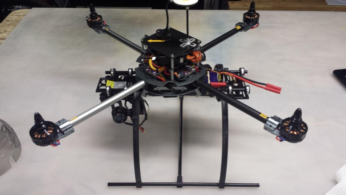

shiftty
Flew it officially today, but had to remove the gimbal (sans Gopro already) because it is so far out of balance. Plan is to have aluminum or CF legs at the extremities for stability.
Hovers at just below 50%, very happy with that.
PROGRESS!
shiftty
Any suggestions on clamps to attach straight CF legs on the arms? 14mm tubing, googling is coming up short. Thinking about having some 3D printed, anyone seen anything like that?
